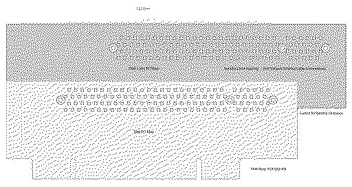

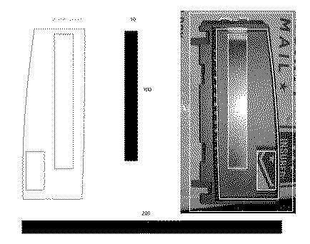

Parallel Developments:
TAM - Internal PicoPSU - AUX Power for Expansion Slots
TAM - Fatback - Printable copy & FatterBack maximum expansion Mod of baseline model?
Cardboard template development, close approximation achieved I think:
Baseline TAMtent w/ Rage128/DVD Daughtercard
TwinSlot adapter card at standard PCI interslot spacing. Rage128/DVD Daughtercard + MacallyUSB installed, plenty of clearance"
Physical design test: clearance of USB Card at standard PCI interslot spacing. Rage128/DVD Daughtercard + Tango2 installed:
Top, setback slot can be spaced closer to standard riser slot than PCI spec for additional clearance for combo card. Depending upon actual spacing or inner surface it may fit with standard interboard spacing. There looks to be more height available at the inner surface level than the template would indicate?
SidePlane-00.jpg [View]
FatBackTent-in-6500.JPG [View]
Rage128DVD-MacallyUSB.JPG [View]
Rage128+Tango2-in-TAMlines.JPG [View]

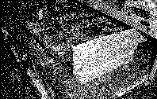

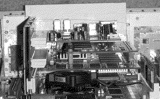

May 28, 2024 - #4

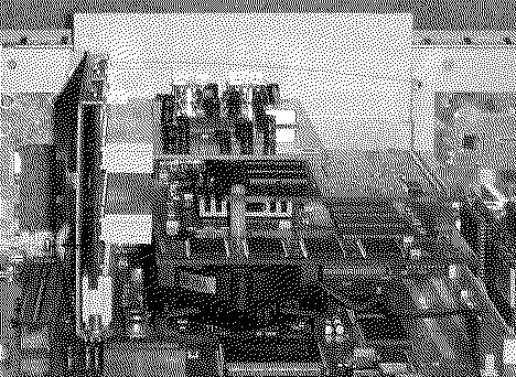

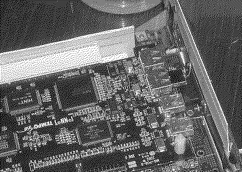

Last pics for the day:
Mock-up in my 6360 with Sonnet Tempotrio in the top/setback slot. Card isn't supported in the funky Gazelle architecture of the TAM/5500/6500, but docs say Alchemy Macs are supported. USB, Firewire and faster ATA/133 bus all on one card.
Slot connector is spaced .2" lower than the standard 2cm PCI slot spacing. There's some wiggle room to increase the spacing a bit.
Top slot is set back far enough for cables to be hooked up internally and snaked wherever for whatever. In my 6360, FW/USB will likely be routed out the vestigial PDS Card opening or wires terminated to connectors on a PCB in that location.
It's too bad this puppy won't play nicely with the TAM, ATA/133 and SSD would make it scream. Wondering if 6360 will outrun the TAM despite its slower bus, given faster disk I/O?

May 31, 2024 - #14
Hrmmm . . . how much does the CPU actually do while communicating with a network?
Your posts, especially that video, have me energized to take the physical experimentation cardboard mockups to fruition. I'd love to send that guy a riser that interfaces correctly with the fatback slot cover's support and lid. :p
TwinSlot-TAM-Riser_BETA.jpg [View]
May 31, 2024 - #15
Can anyone take some pics from the "inside" of the FatBack with a card and its PCI riser bolted up to the slot cover for me?
Clearance measurements between the top of the stock riser and inner surface of the lid would be a huge help. This is about the only time I've ever been interested in having a TAM in my collection.
Developing a printed sideplane has been a casual interest in this five year backburnered project.
May 31, 2024 - #16
Is anyone in the U.S. interested in doing the physical/fitment testing the cardboard prototype for me? No harm can be done by my paper/cardboard doohickey.
pm if interested. ;)

Jun 1, 2024 - #20
>> Francois said:
AFAIK the PSU of the TAM is the same PSU used in the Power Mac 6500 and you can install two PCI cards in the 6500. Click to expand...
Looks like you're probably right. Development was hurried, so they must have used the already UL approved 6500 PSU? What a kluge! :rolleyes:
My 150 W 6500(?) PSU looks a lot like that picture. Only the A/C passthru for display connection is missing. Looks like the metal housing is enclosed in a plastic cover?
From the service source specs:
6400 - 220 W maximum continuous
6500 - 140 W maximum continuous
TAM - Max Watts: 140
Is there a teardown/repair video of the TAM base unit? It's service source is the only one I can recall without the exploded diagram. Apparently Apple was too embarrassed about how friggin' ugly the TAM insides were to provide one, someone might even take it apart! Yep, can't judge a book by its cover.
Entire PSU transplant or transplant of the guts of the 6400 PSU into the TAM can/base unit would appear to be the easiest way to get the additional power required. Methinks the LCD and its craptastic controller board likely devours more than an L2 G3 and second PCI slot's share of 140 W?
Screenshot 2024-06-01 114733.jpg [View]
