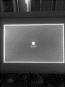

Dec 7, 2023 - #15
Well, my friend, Michael, received the Battery Eliminator and got it to power his 5126 backlit model, although he shared the following photo with me to show it displays a Sad Mac error...
[Image: 403612292_339034535495661_3318943783375116786_n.jpg]
0000000E <-- Bus Error? RAM error?
0000FFFF <-- unknown
He also says he needed to boot from a floppy in the past in order to get the Conner hard drive to work. I cannot comment on that because I have zero experience with the Macintosh Portable.
This is, perhaps, the first person who has tested the 5126 with the Portable Battery Eliminator. @Androda ... Any thoughts?
403612292_339034535495661_3318943783375116786_n.jpg [View]

Dec 7, 2023 - #16
0000000E <-- Bus Error? RAM error? 0000FFFF <-- unknown Click to expand...
Is he saying that there is no sad mac error code without the battery eliminator installed, and getting a sad mac error with the battery eliminator installed?
According to the Sad Mac Error Codes reference, that's a memory error saying all 16 bits are not responding properly. But there are no RAM-related signals present on the modem slot according to the schematic. The only signals I'm using are a ground pin and the 5v power line (5v is an input to the card, not an output from the card). And the backlit portable dev note doesn't mention anything about changes to the modem slot (unlike the RAM slot, which does have a few differences).

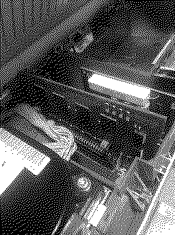

Dec 7, 2023 - #17
We installed the Battery eliminator because the battery went dead and the Mac would not start up, or so I thought, this unit to my knowledge has not been recapped so not sure if it's that but this is a error described here...
Macintosh Classic Sad Mac 0000000e / 0000ffff
By: Admin On: July 20, 2021 In: Uncategorized
I wanted to write about this Macintosh Classic as it stumped me for a bit. We had replaced UH6 which is a LS174 that handles timing for the CAS circuit. When booted, the system just showed a sad Mac with the error code 0000000e.
This error means there has been a data bus error. The last four numbers of second row are the 32 bits representing the failed bits. In our case, it's all of the bits.
This could be caused by a number of things but generally it is related to the LS174. We verified all of the address lines were present and working. We checked the output pins and they were looking about what we expected. On a whim I checked the ground pin...no beep. Fixing the missing connection got the board working again. I haven't traced to see where the failure is yet but I plan to.
Ok I am using a MacEffects Memory card that could be the problem see here...
So in finishing is the card damaged or is this needing a recap in order for the card to be seen and available to the motherboard?

Dec 7, 2023 - #18
>> MICHAENTOSH said:
this unit to my knowledge has not been recapped Click to expand...
That's a huge problem for Portables. I suggest that you don't run any more power through the system until the capacitors have been replaced and all the leaked capacitor fluid damage has been repaired. The leaking electrolyte causes tons of problems, everything from primary voltage regulator instability (which kills components) to internal motherboard PCB trace damage.
>> MICHAENTOSH said:
Ok I am using a MacEffects Memory card that could be the problem see here Click to expand...
That's not very likely to cause problems in this case.
>> MICHAENTOSH said:
So in finishing is the card damaged or is this needing a recap in order for the card to be seen and available to the motherboard? Click to expand...
The Battery Eliminator card was tested in my Portable before shipment. It should work without any issues.
It is likely the problems you are experiencing here are related to the lack of capacitor replacement. Even without any power applied to the system, capacitor fluid is very electrolytic/corrosive and likes to creep up the legs of ICs and cause internal shorting. Applying power just makes the capacitor fluid cause damage faster.

Dec 7, 2023 - #20
@MICHAENTOSH and I have been discussing his 5126 Portable privately, and he mentioned the need in the past to boot from a floppy in order to get the Conner Hard Drive to boot, which baffled me. I can only assume that strangeness must pertain to the capacitors as well? Click to expand...
It could be related. There are leaking capacitors in the 12v generator circuit, and I believe both the original hard drive and floppy drive require 12 volts. Might only be able to power one at a time with the leakage. Low or improper capacitance on the boost driver (boosting from battery voltage to 12 volts) may even cause over-voltage on the 12v line as the capacitors aren't able to absorb the inductor-driven boost pulses properly.
I have zero experience with the Macintosh Portable, so I don't know the common failure modes. I know about recapping other machines, but I don't know what damage is typically caused on a Mac Portable by running power through the machine while caps are leaking. But it seems you are saying pretty much anything could be fried and permanently damaged on the motherboard if powered in that leaky cap condition? Click to expand...
In the case of the Mac Portable, failing to replace the capacitors can cause extensive damage. The main 5v regulator's precision analog resistors are right next to a leaky capacitor on the M5126. Those analog resistors are precision for a reason - and that 5v rail can swing all over the place (lower than it should be, all the way up to battery voltage) due to the corrosive fluid affecting resistor values. 7-ish volts at the battery is way higher than the 5-ish volts that most components on the PCB are designed to accomodate.
Overall, using a vintage system without checking the capacitor state is asking for trouble. And on the Portable that trouble is amplified by the oddball power system.
