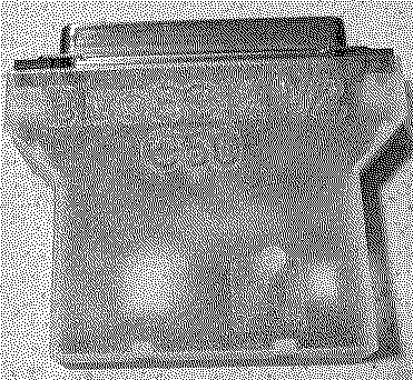

A new version of the BlueSCSI V2 Centronics 50 Pin is now available:
Like it says in the URL, this is literally a shorter version of the previous design.
Similar to the smaller DB25, it's over 1cm shorter than the prior version and has termination always-enabled.
