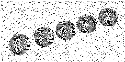

Hi @0dan0 , do you mind to share the iris STL file?
I've tried to search for it but could not find any, by searching online:
Thank you! F.

Here is the STL for all five. I'm using the second smallest, as I think the two largest are effectively wide open. I printed with TPU, as might be too tight for a non-flexible filament.
FStopsM12.zip (45.2 KB)
Liked by Federico

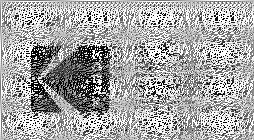

Here is v7.2, a month more of tinkering. This adds more debugging, Qp level (showing the current encoding quality) and a live frame counter (mainly showing the 25 fps update rate.) When running the English language mode, "Tint" has been replaced with "Saturation".
Hacks relates to jitter, even less is running at encoder start.
FWDV280-TypeA-V72-0dan0.zip (5.5 MB)
FWDV280-TypeB-V72-0dan0.zip (5.5 MB)
FWDV280-TypeC-V72-0dan0.zip (5.5 MB)
BootLogo1600x1200-V7.2A.png [View]
BootLogo1600x1200-V7.2B.png [View]
BootLogo1600x1200-V7.2C.png [View]
Liked by Federico,lrussell887,Kai Robinsonand 3 others
