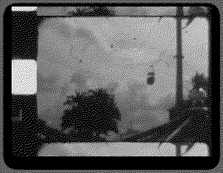

Hello @0dan0,
FYI I encountered this interesting glitch after I was zooming in and out of the frame, and it is persistent after power cycling. Notice how the top section has a hard line. It's like it's repeating a section or cutting out a section.
I haven't updated the FW in a while, so maybe this is just a side effect of the additional zoom/frame adjust options. However, just sharing in case it's helpful. In addition, when zooming in and out, the screen can glitch out for a fraction of a second, displaying horizontal bars for a moment.
FW model: 7.6.1
HW model: A
Thanks again for all your hard work!

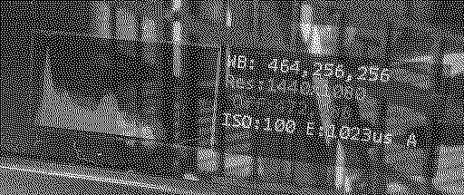

>> Mac84 said:
Hello @0dan0 , FYI I encountered this interesting glitch after I was zooming in and out of the frame, and it is persistent after power cycling. Notice how the top section has a hard line. It's like it's repeating a section or cutting out a section. I haven't updated the FW in a while, so maybe this is just a side effect of the additional zoom/frame adjust options. However, just sharing in case it's helpful. In addition, when zooming in and out, the screen can glitch out for a fraction of a second, displaying horizontal bars for a moment. FW model: 7.6.1 HW model: A Thanks again for all your hard work! Click to expand...
I expect your new lens might be pointing to far to one side. When you are reframing to centering, might be using some out-of-range values. During preview share these numbers:

Dec 24, 2025 - #100
>> 0dan0 said:
I expect your new lens might be pointing to far to one side. When you are reframing to centering, might be using some out-of-range values. During preview share these numbers: View attachment 25499 Click to expand...
Thanks! I'll try a new 3D printed mount - thankfully the issue went away after zooming in and out a few times.
