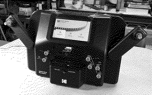

Hello everyone,
Welcome to the new thread!
Here we can continue discussing the Kodak Reels 8mm film digitizer and some cool, unsupported modifications some smart folks have discovered to improve the capture quality of this product.
 Thank you to everyone who has helped in this project since it's creation! [face-with-party-horn]
This project began in 2023 and the original thread sparked nearly 900 replies, 48 pages of discussion, and over 100,000 views! Therefore, it was time to do a bit of a reset. The goal is to consolidate information for newcomers and help better organize updates and how-to information inside, saving folks from sifting through 45 pages to find answers.
The original thread is still available to view, but all new discussions will take place here to avoid conversations getting lost. If you have a Wolverine model film digitizer, please see this helpful article "Firmware hack fo Wolverine 8mm film digitiser" by @Branchus.
An in-depth video review of the Kodak digitizer and an exploration of firmware options:

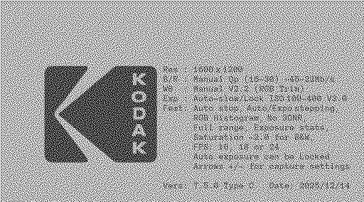

Here is v7.4.1. Just a bug fix (although important.) If the permanent memory was in the wrong state (7.4.0 wasn't initializing it), the unit could have been locked to the wrong exposure values, with no way to change it. This version will reset the locked exposure settings on firmware update to avoid this illegal state.
For anyone else trying to customize firmware, you may have found NktTool frustratingly slow. It uses two Windows compiled utilities from https://github.com/str2b ntkcalc and bfc4ntk. These where 32-bit compiled, so I recompiled at 64-bit for more speed. I also found a flaw in ntkcalc, that makes that step a thousand times faster. So the whole process now takes only 8-10 seconds.
Unzip NewNtkTools2025.zip into the folder in which you are editing .rbn files. Double click on build_local.bat, and it will make a FWDV280.BIN from the most recent .rbn in the same folder automatically and fast.
FWDV280-TypeA-V741-0dan0.zip (5.5 MB)
FWDV280-TypeB-V741-0dan0.zip (5.5 MB)
FWDV280-TypeC-V741-0dan0.zip (5.5 MB)
NewNtkTools2025.zip (186 KB)

Here is v7.5.
Additions:
- You can customize all the RGB gains for white balance, to deal with very blue (or red) film.
- The font has been increased in size for improve readability.
- FPS, EV, Qp and Frame count are now only during capture.
Bug fixes:
- Sometimes the ISO/Shutter wasn't displaying correctly.
FWDV280-TypeA-V75-0dan0.zip (5.5 MB)
FWDV280-TypeB-V75-0dan0.zip (5.5 MB)
FWDV280-TypeC-V75-0dan0.zip (5.5 MB)
BootLogo1600x1200-V75A.png [View]
BootLogo1600x1200-V75B.png [View]
BootLogo1600x1200-V75C.png [View]
1765761547052.png [View]
Liked by Mac84,sheiderandThePhage

The Picture setting still set the white balance like before, with has a maximum of 9 WB settings. Now during recording you can tweak red, green and blue, up and down as much as you like, it will remember any changes. Unfortunately I yet to implement a reset, to restore the defaults. The firmware update will reset RGB gains to there default offsets. If you change red or blue, off the defaults, the value will be odd, rather than even. I didn't do this with green, as I was just preserving the existing behavior with that channel.
WBAL (current defaults)
2.0 384,256,256
1.5 352,256,256
1.0 320,256,256
0.5 288,256,256
0.0 256,256,256
-0.5 256,256,288
-1.0 224,256,320
-1.5 96,256,448
-2.0 64,256,448
