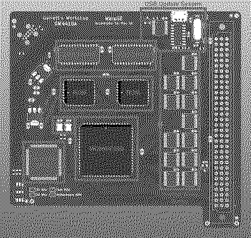

I wanted to post about my new design for a 25 MHz 68HC000-based Macintosh SE accelerator. As usual with my gizmos, this is a collaboration with Garrett Fellers of Garrett's Workshop. I'm the principal designer and Garrett is the codesigner and he manufactures our boards.
My aim with this card is to achieve a speedup of 3x or so while maintaining the greatest degree of compatibility with applications. Therefore I have employed an MC68HC000 running at up to 25 MHz instead of an '030. The card has 4 MB of legacy 60ns DRAM onboard which can be accessed with 0 wait states at 25 MHz. The Macintosh SE ROM is also reproduced on the board in two 512kx8 70ns flash ROMs. In order to achieve the requisite 3x speedup on graphics performance, I have implemented a longword posted write buffer. This lets the accelerated CPU write to video/sound memory up to twice in a row with 0 wait states. The accelerator trickles out these writes from the fast CPU to the slower PDS bus while the fast CPU gets to continue executing from RAM or ROM memory on the card. CPU speed is selectable, either 20 MHz or 25 MHz. The current board is using the Xilinx XC95144XL-10TQG100C CPLD to implement the control logic but that's just because we at GW have a few trays of them from a cancelled project. The control logic is amenable to implementation in the Lattice LC4128Z/E/C/B/V CPLD too.

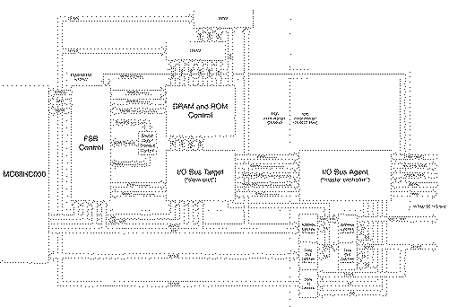

The CPLD on the bottom left controls everything. Here's a block diagram of the system including several functional units inside the CPLD as well as external components like the ROM, RAM, 68k CPU, and the latches for the posted write buffer.
Of course, my description above sort of just scratches the surface. There are four main blocks in the CPLD shown in the diagram above. These are the FSB controller, DRAM/ROM controller, I/O bus target (i.e. slave port), and I/O bus agent (i.e. master controller). I have tried my best to specify the behavior of these blocks in my timing diagrams available here: https://garrettsworkshop.github.io/WarpSE/Documentation/index.html
These are complicated but I'm hoping some of our skilled members can take a look. The diagrams are a bit of a work in progress but I believe they all basically make sense.

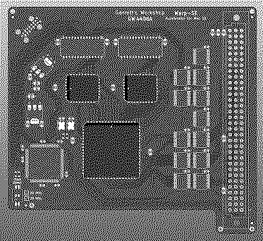

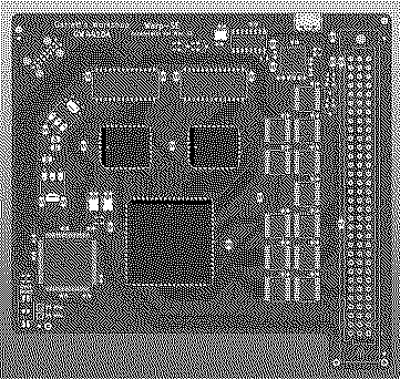

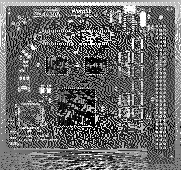

Here's an annotated render of the board showing where the external components are placed:

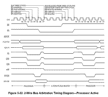

I was wondering how the system knows to use the accelerator in the PDS slot. Looking at the MC68000 datasheet it seems to start off by asserting /BR (active low in this case) from the co processor which in this case would be the accelerator. Looking at the pinout for the SE PDS slot it should be PIN 3A and if I look at the PCB for Warp-SE it's looks like it's just grounded.
So am I correct to assume that to simply disable the main processor and use the one on the PDS slot you just need to ground the /BR pin?
I'm curious because it would be cool to just have a PDS card with a socket to test 68000@8Mhz chips on a Mac SE. I guess it would also be useful to test a PiStorm without having to desolder the CPU from the board.
Zane Kaminski
Columbus, Ohio, USA
Joined: Sep 5, 2021
Posts: 372
Likes: 615
Nov 5, 2021 - #8
>> alxlab said:
to simply disable the main processor and use the one on the PDS slot you just need to ground the /BR pin? Click to expand...
Yeah basically. /BR low makes MC68k give up the bus after the current /AS cycle. So your hardware can pull /BR low, then wait two clocks (in case MC68k has already decided to start a new bus cycle concurrent with your /BR request). Then you watch for /AS high, indicating that MC68k is done with the current cycle and will release the bus. Or you can watch /BG which goes low one clock (IIRC) before the /AS cycle ends. Using /BG lets you skip waiting to see if MC68k has decided to start another cycle before processing the bus request, in the sense that /BG won't go low until right before MC68k is actually gonna give up the bus rather than starting another cycle. Once /AS is high after the /BG assertion (and you've either waited two clocks or seen /BG low) the alternate master can drive the bus. So you don't have to use /BG as long as you account for MC68k possibly starting a new bus cycle concurrent with your bus request.
Once your card has the bus, it's not required to assert /BGACK. MC68k won't take the bus back unless both /BR and /BGACK are inactive, so instead of /BGACK you can just keep /BR low while using the bus. The idea is with /BGACK is to accommodate multiple alternate masters. The first alternate master to request the bus does so, then asserts /BGACK and desserts /BG. MC68k sees /BGACK low so it doesn't take the bus back even though /BR is no longer asserted. Then a second alternate bus master can pull /BR low to request the bus while /BGACK indicates that the first alternate master still has the bus. Once the first alternate master releases the bus, /BR is already low so MC68k doesn't take the bus back and the second alternate master gets a chance to master the bus. So /BGACK is not so useful unless you have two alternate bus masters.
So yeah, just tie /BG low and MC68k will give up the bus. No need to look for /BG or assert /BGACK. There's one gotcha though. MC68k drives the bus immediately following /RESET going low. Then after reset is released, it's not clear from the manual whether MC68k immediately releases the bus or whether it takes time to do so. So you shouldn't just have your address bus drivers on an alternate master card always active, otherwise there might be some bus contention at startup. So you oughta gate your address driver /OE pins with /RESET and then also synchronously count a few clocks after reset is released before the address drivers are enabled and a bus transaction is allowed to take place.
Liked by tragandalxlab
alxlab
Posts: 293
Likes: 323
Nov 5, 2021 - #9
Yeah basically. /BR low makes MC68k give up the bus after the current /AS cycle. So your hardware can pull /BR low, then wait two clocks (in case MC68k has already decided to start a new bus cycle concurrent with your /BR request). Then you watch for /AS high, indicating that MC68k is done with the current cycle and will release the bus. Or you can watch /BG which goes low one clock (IIRC) before the /AS cycle ends. Using /BG lets you skip waiting to see if MC68k has decided to start another cycle before processing the bus request, in the sense that /BG won't go low until right before MC68k is actually gonna give up the bus rather than starting another cycle. Once /AS is high after the /BG assertion (and you've either waited two clocks or seen /BG low) the alternate master can drive the bus. So you don't have to use /BG as long as you account for MC68k possibly starting a new bus cycle concurrent with your bus request. Click to expand...
Yeah that makes a lot of sense after looking at the MC68000 timing diagram for 2-Wire bus arbitration.
Once your card has the bus, it's not required to assert /BGACK. MC68k won't take the bus back unless both /BR and /BGACK are inactive, so instead of /BGACK you can just keep /BR low while using the bus. The idea is with /BGACK is to accommodate multiple alternate masters. The first alternate master to request the bus does so, then asserts /BGACK and desserts /BG. MC68k sees /BGACK low so it doesn't take the bus back even though /BR is no longer asserted. Then a second alternate bus master can pull /BR low to request the bus while /BGACK indicates that the first alternate master still has the bus. Once the first alternate master releases the bus, /BR is already low so MC68k doesn't take the bus back and the second alternate master gets a chance to master the bus. So /BGACK is not so useful unless you have two alternate bus masters. Click to expand...
Ah that makes a lot of sense. So basically this would be required if there's more than 2 CPUs that would take over the bus.
So you shouldn't just have your address bus drivers on an alternate master card always active, otherwise there might be some bus contention at startup. So you oughta gate your address driver /OE pins with /RESET and then also synchronously count a few clocks after reset is released before the address drivers are enabled and a bus transaction is allowed to take place. Click to expand...
So just to make sure I understand correctly, if I want to just slap a CPU on a PDS card that will run at the same clock speed as the original MC68k then in this case the CPU on the PDS card, then the "address bus drivers on an alternate master card" would be the CPU on the PDS card and should be turned off until after a few cycles the /RESET is inactive to avoid contention?
This is like learning an entirely new language. Needing to learn what thing like "assert, "negate" and "driver" means.
Hopefully I'll learn enough to understand and not fry anything. :D
I really appreciate the time your taking to go through and explain this stuff.
If anyone else is interested in the source of the timing diagram I've attached the MC68000 Reference Manual I took it from.
MC68000UM.pdf (2.2 MB)

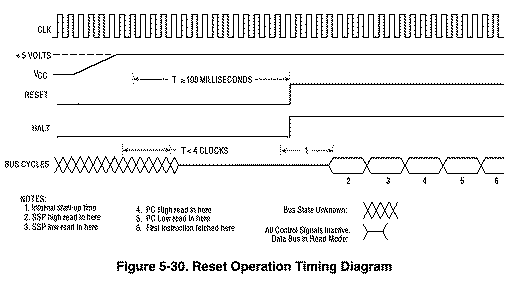

Hmm I think I may have been misremembering about MC68k driving the address bus during reset. Check this diagram from the user's manual:
It's more that MC68 might drive the bus before 4 clocks after Vcc has reached minimum operating voltage. Seems explicit that it doesn't drive the bus while reset is asserted. But what's unclear is whether MC68k will recognize the bus request right after reset. I guess if the bus request is recognized during the "internal startup time" then MC68k won't start loading the initial stack pointer and whatnot. So upon revisiting it I think inhibiting your card's address/control outputs is not necessary. This makes sense since otherwise you couldn't hook multiple MC68000s to the same bus without buffers in between.
Edit: No, wait a minute. The diagram says, "all control signals inactive." So that means high, not tristate and therefore you seem to have to disable the control signal outputs but not the address and data buses.
Screen Shot 2021-11-06 at 2.19.56 PM.png [View]

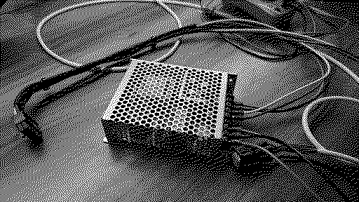

Get yourself a Meanwell RT-65B Power Supply, some wire and a 14-pin Molex Mini-Fit Jr plug & crimp tool - you can make a really simple bench power supply for these :)
