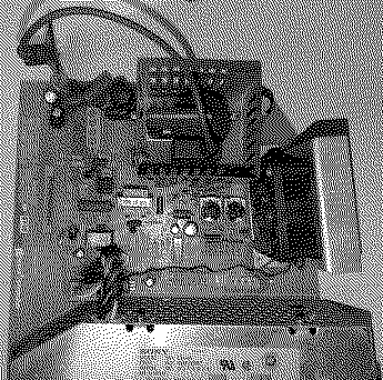

I'm new to this forum, and fairly new to some aspects of vintage computer repair even though I've used 'em since they weren't vintage. I've dug through these forums and others but not seen an issue quite like the one I'm dealing with.
I've got an SE/30 that, until this past year, I didn't even know worked - I was given it along with several other partial compact Macs by a friend years ago, and they sat in a shed that wasn't terribly watertight, so when I dug them out for a project, there was plenty of surface rust, and the mainboard was a bit crusty looking, but fortunately not battery bombed. After a reasonable cleaning, and wiggling the ROM SIMM a bit, it came to life, and it's got an external video card in it, even!
In the process of making it more presentable, I've swapped the analog board for a spare from an SE that had a good flyback transformer, recapped THAT board, the power supply and the mainboard with kits from Console5, put a new battery in and replaced the HDD (which I managed to get working enough to back up) with a BlueSCSI. It now boots (and chimes) and runs reliably, and for the most part, looks great.
Except there's noise in the video that gets stronger as it warms up - after about ten minutes, it reaches a peak and stays there. I saw it surge with HDD activity while I was working on recovering the files that came with it, but that part isn't in the machine. I've tried replacing the HOT and reflowed the analog and CRT boards, but am unsure where to look next. The caps on the mainboard leaked at least a little, at least judging by how they looked when I removed the old ones, but I don't see much of anything that looks like corrosion beyond all the solder on the board being dull and slightly soft (fuzzy?) looking - no green crud. All of the pads came clean easily and everything looked good to my eyes otherwise. I swapped the CRT board with the one from the SE, and the noise changed a bit but didn't go away. The only consistent thing I can to to reduce the noise is to turn down the brightness - the brighter it is, the stronger the noise is. The pictures attached show this at normal brightness (the noise moves randomly like static) and one turned almost to nothing, edited to be more visible. I also haven't seen any rogue solder or bridged connections, though it's always possible that I missed one.
Would the CRT board be the next thing to investigate, or should I still be looking at the motherboard or somewhere else? I've always been good to hang parts, and now I feel more confident I can solder them, but circuit-level diagnosis is still kinda new to me.

This is likely a bad cap on the analog board based on your post. There is a capacitor adjacent to the flyback which has likely started to fail and is leaking.
It might not be obvious from the component side but will be clearly visible after removing it or from the solder side where the electrolyte tends to wick through.
Recap is necessary on all three boards ( logic, analog and psu ).
I used a slightly higher voltage rated electrolytic near the flyback ( 50v ) as I think the original voltage rating is underspeced and that seems to be a common failure in the analog.board.

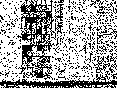

Just to be clear, you are citing the problem of little wave-shaped oddities that look like this...
QUESTION: You said you swapped the analog board. That made ZERO difference? If so, what about the Yoke Board and its connector? Dirty?

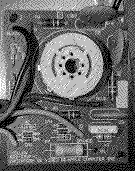

I checked the yoke connector, since it did have darkened plastic around one pin. I replaced the socket with the nice clean one from the donor board. I also tried the CRT from the SE, and it MIGHT have been a bit better, but the geometry was far worse - the left side was neither a straight line or an arc, but had an indentation near the top left corner. Not sure I want to mess with yoke adjustments yet, so I cleaned the contacts on the original yoke as much as possible, reinstalled the original CRT and it, again, MIGHT have gotten a bit better but is still easily noticeable. I've checked and rechecked solder joints but everything seems as solid as it can be.
I keep going back to the flat round capacitors and wondering if they're part of the problem. Maybe some more experienced eyes will see something I haven't, so board pics are attached.

First thing. Tweaking geometry on compact Macs is fairly simple compared to other CRTs. Just rotate the magnets to bring the top left corner into position, you will have to break the white glue which secures them into position. Just note that if you make one adjustment then you may need to adjust the others as well. You have to do it while the machine is on, so take the necessary precautions. Use gloves as your hand can get close to the anode and analog board.
I see 4 x 47uf SMD electrolytics on your mainboard which have leaked and appear to be the originals ( c3,c4, c9 and c10 ), the others have been replaced with SMD tantalums . You absolutely have to replace the 47uf as well.

But in regards to the suggestion to touch those little square magnetics, I'd exercise caution because they won't cure the small waves shown in the closeup I posted in my previous post...
The square magnets won't fix that, and the way I read the opening post was that he is most concerned with that. But whether the motherboard was fully recapped or not, those waves aren't caused by the motherboard. I can tell you that right now. It's on the Analog side. I just don't have any idea what might be causing the waves.
