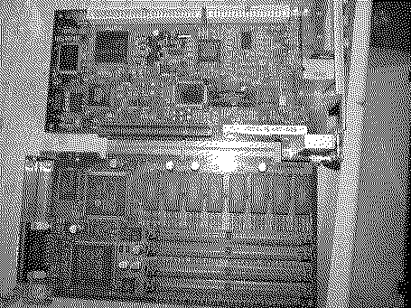

Demonstration that Beige G3 Personality Slot and X100 PDS Slot are Same:
Two photos because I wasn't sure whether with flash and reflection was better or worse than without flash, so dimmer, but no reflections.
I should qualify that both the slots use the same connector. They are not the same electrically.
IMG_1515[1].JPG [View]
IMG_1516[1].JPG [View]
Liked by alxlabandKai Robinson
