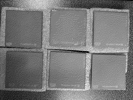

Let's play spot the fakes

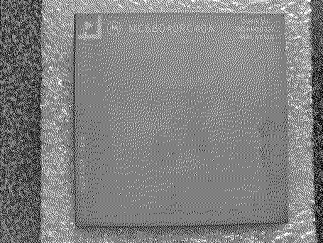

recieved another one today. looks legit

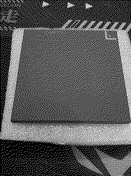

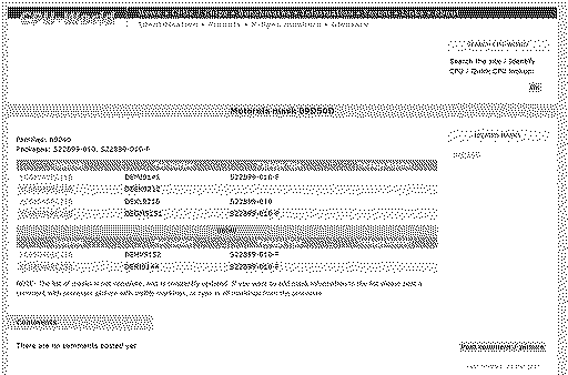

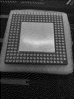

Time to revive this thread. Took a read thru, but TBH it went over my head. My alleged MC68040RC40 arrived today, but it has no markings on it except for the S22899-010-F screenprint. I found the below but also, they say the list of masks is not complete. If I connect it to my LC575, is there some way to get verification via the OS or software?
If I can't verify, I'm getting everything refunded via eBay buyer protection.
See attached pics.
