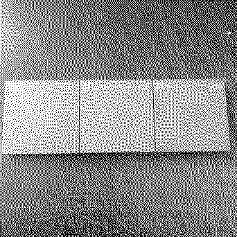

Mr. Fahrenheit
Posts: 141
Likes: 232
May 18, 2022 - #44
>> bakkus said:
Fantastic! Could this table be placed as an article under Resources as well? Click to expand...
I'm still curating this information. It's not complete yet.

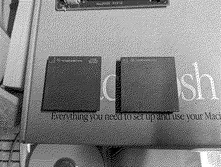

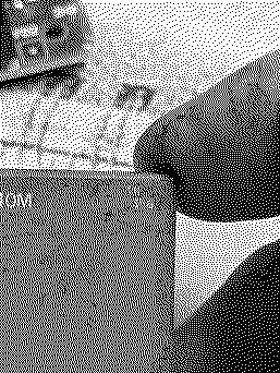

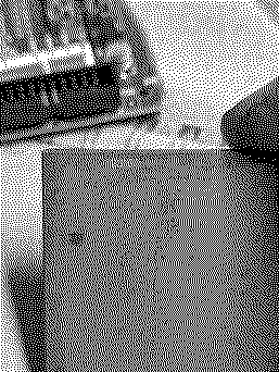

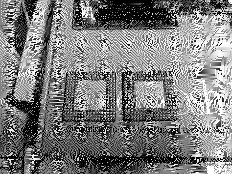

May 27, 2022 - #46
So the last Eric Woo chip has just arrived. I've attached photos of the altered chip and the new one. Also are both underneath shots.
The markings on the new chip are almost impossible to see, but its just only cleaned and not re-masked. I'm also not sure of what the H in the XC68040HRC40M is in reference to.
If anybody has a some more tests besides MacBench to run, please let me know.
Have a good one!

Mr. Fahrenheit
Posts: 141
Likes: 232
May 28, 2022 - #47
>> Gazmassive said:
So the last Eric Woo chip has just arrived. I've attached photos of the altered chip and the new one. Also are both underneath shots. The markings on the new chip are almost impossible to see, but its just only cleaned and not re-masked. I'm also not sure of what the H in the XC68040 H RC40M is in reference to. If anybody has a some more tests besides MacBench to run, please let me know. Have a good one! PS (excuse the dirty hands, being a diesel mechanic has its downsides) View attachment 5293 View attachment 5294 View attachment 5295 View attachment 5296 Click to expand...
HRC is supposed to indicate that the chip was binned for producing less heat.
I do not know how accurate that is.

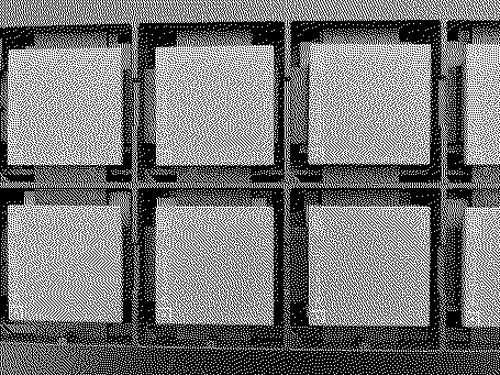

Aug 9, 2022 - #54
>> C128 Guy said:
Think these are real? MC68040RC33 | eBay Find many great new & used options and get the best deals for MC68040RC33 at the best online prices at eBay! Free shipping for many products! www.ebay.ca Click to expand...
Nope. A glance at the seller's rating and the photo combined with my gut screams fakery. [face-with-monocle]
