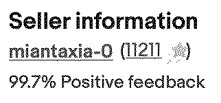

>> Mr. Fahrenheit said:
I purchased two x 68040 40mhz CPUs, supposedly L88M from this eBay seller: 1PCS MC68040RC40A MPU ColdFire Processor RISC 32bit 40MHz 179-Pin PGA Tray | eBay Find many great new & used options and get the best deals for 1PCS MC68040RC40A MPU ColdFire Processor RISC 32bit 40MHz 179-Pin PGA Tray at the best online prices at eBay! Free shipping for many products! www.ebay.com They are not legitimate. They are remarked fakes. See attached photos. Click to expand...
Just goes to show that observing a seller's feedback alone is insufficient to determine if what you buy is the real deal...
When viewing your photos, @Mr. Fahrenheit, what specifically must web observe which proves they are fake? (I ask out of ignorance here... not trying to be argumentative.)
Also, what happened with those CPUs in your testing? The reason I am curious about that is because, as you know, I purchased a 40MHz rated 040 from UT Source and found the markings came off after @Kay K.M.Mods applied a heatsink with 2-sided thermal tape and then later removed it. The authentic chip markings won't come off like that, proving it was remarked. However, despite that serious warning sign, I was able to overclock it with Spicy O'Clock to 49.2MHz using your 60ns VRAM (and also that of Drake), and later I was able to overclock 1MHz higher with the 2-chip low-latency SMC VRAM. In other words, despite the remarking (which means I have no idea if it was originally a 40MHz rated or 33MHz rated chip), I can overclock it to amazing speeds, and the temperatures never rose above the 60's*C.
So in my mind, I view the remarked chips in two categories: (1) remarked chips that are known to be low-megahertz and cannot be overclocked very high and/or get very hot, and (2) remarked chips that can be overclocked and don't get very hot. Maybe even the sellers don't know which category they fall into, assuming the sellers weren't the one's who remarked them. Maybe they bought a bunch of old chips from another vendor on the cheap and then just resold them?
All said, it would seem that the only way to know what your getting is to get an authentic chip, and then main way to guarantee that is to pull it from an old Quadra or another 040 Mac or Amiga. But few people would probably do that, as such would render that machine unusable. Then again, I am willing to sacrifice a Quadra 630 to donate parts (like a speaker for the stereo mod) into a Color Classic because the Color Classic is the better machine overall. I did just that a few months back in fact (just haven't made the video yet).

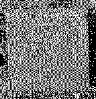

May 14, 2022 - #24
Just goes to show that observing a seller's feedback alone is insufficient to determine if what you buy is the real deal... View attachment 4973 When viewing your photos, @Mr. Fahrenheit , what specifically must web observe which proves they are fake? (I ask out of ignorance here... not trying to be argumentative.) Also, what happened with those CPUs in your testing? The reason I am curious about that is because, as you know, I purchased a 40MHz rated 040 from UT Source and found the markings came off after @Kay K.M.Mods applied a heatsink with 2-sided thermal tape and then later removed it. The authentic chip markings won't come off like that, proving it was remarked. However, despite that serious warning sign, I was able to overclock it with Spicy O'Clock to 49.2MHz using your 60ns VRAM (and also that of Drake), and later I was able to overclock 1MHz higher with the 2-chip low-latency SMC VRAM. In other words, despite the remarking (which means I have no idea if it was originally a 40MHz rated or 33MHz rated chip), I can overclock it to amazing speeds, and the temperatures never rose above the 60's*C. So in my mind, I view the remarked chips in two categories: (1) remarked chips that are known to be low-megahertz and cannot be overclocked very high and/or get very hot, and (2) remarked chips that can be overclocked and don't get very hot. Maybe even the sellers don't know which category they fall into, assuming the sellers weren't the one's who remarked them. Maybe they bought a bunch of old chips from another vendor on the cheap and then just resold them? All said, it would seem that the only way to know what your getting is to get an authentic chip, and then main way to guarantee that is to pull it from an old Quadra or another 040 Mac or Amiga. But few people would probably do that, as such would render that machine unusable. Then again, I am willing to sacrifice a Quadra 630 to donate parts (like a speaker for the stereo mod) into a Color Classic because the Color Classic is the better machine overall. I did just that a few months back in fact (just haven't made the video yet). Click to expand...
The date code in the corner does not correspond to the Motorola logo, and the mixed corner logo (one being a circle, the other being a triangle), along with the surface appearing to be buffed/sanded down, and the serial numbers on the left side end -001 which indicates it's not L88M.
All of these things, and I haven't powered it up yet to know whether they are even full 040 (instead of LC040).
I'll do that test and temperature readings sometime this weekend, hopefully.

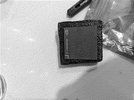

Hi guys, first time long time on the forums and other accounts.
After watching JDW's video on Spicy O'Clock, i decided to go ahead and order a full fat 68040 off UTSource.
After waiting about a month for shipping to Australia, it finally arrived. From all the previous comments, this seems to be another rebranded one.
It has a K88M mask (never seen this before), but in the lower corner is marked as a -010-F, suggesting a very early chip.
Is there a way to test the processor using a tool suite to see if indeed full functionality is present even though its rebranded?
MacBench 3 sees it as a full 040 with FPU and tests ok.
PXL_20220515_102705690.jpg [View]
PXL_20220515_053114391.jpg [View]
May 16, 2022 - #34
>> Gazmassive said:
Is there a way to test the processor using a tool suite to see if indeed full functionality is present even though its rebranded? MacBench 3 sees it as a full 040 with FPU and tests ok. Click to expand...
That kind of testing is the best you can do to determine if it has the full FPU. The next step is to see how high you can overclock it using the fastest VRAM possible and board recapped with the best capacitors. Then you just need to measure the temperature of the CPU while running an intensive benchmark.

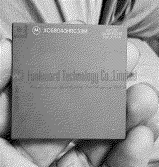

May 16, 2022 - #40
I bought the 68040 below from Eric Woo last summer for my Mystic CC. I've overclocked it to 40 MHz with no issues I've seen so far, with plans to push it even further in a few weeks.
