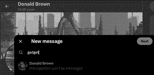

Click on the new message icon in the lower right corner where it says "Messages", then type in his username. Should be able to get ahold of him that way. According to the Eamon Wiki page, he looks to still be alive.

>> Volvo242GT said:
Click on the new message icon in the lower right corner where it says "Messages", then type in his username. Should be able to get ahold of him that way. Click to expand...
Unfortunately, it's not possible...
1713012338505.png [View]

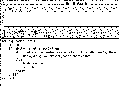

A couple of quality of life updates to stop you accidentally deleting the script itself, and handling nothing being selected.
This is still an extremely dangerous script because as requested, it doesn't do any confirmation before emptying the trash. I'd not actually run it like this myself and would comment out (place -- before the line) the "empty trash" line.
Edit - updated script screenshot for System 7 compatibility (counting selection doesn't seem to work for some reason, at least not how it did in Mac OS 8)
Edit Edit - changed "is" to "contains" so that you can't try to delete the script itself by selecting something else at the same time.
1729504284891.png [View]

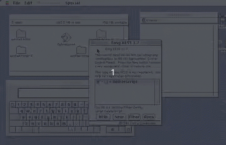

Oct 21, 2024 - #10
Here is a demo of it in use on System 7.5.x (I don't have System 7.1 installed on my emulator, but it should work find as long as you have applescript and Finder 7.1.3 / 7.1.4 from System 7.1.2 (Edited out an error where I said Finder 7.1.2, instead of the Finder from 7.1.2).
The low framerate is missing most of the times I press delete sorry, but I am pressing it.
AppleScriptDelete.gif [View]

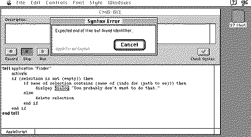

I tried typing in your script manually (since the text of your script was not available). I merely left out "empty trash" because I don't need that. CMD-DEL in S7.5.5 works by merely casting your selection into the Trash without emptying the Trash.
Unfortunately, it won't compile and complains as follows:
I installed System 7.1 Pro exactly as I describe here:
After that, I installed AppleScript 1.0, which installs Script Editor 1.0.1.
Finder version is 7.1.4.
Please advise where I went wrong.

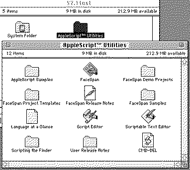

I installed AppleScript 1.1 using these disk images. During the install, it told me that it would install an older version of the Finder. Not sure why AppleScript should even be replacing the Finder, but it did. It installed 7.1.3, overwriting 7.1.4.
These are all the files it installed:
Sadly, it still complains in the same way when I click the Check Syntax button:
You can download my *.dsk containing the System 7.1.2 install and AppleScript 1.1 here:
I boot that image using the Mini vMac MacII version.
1729586341504.png [View]

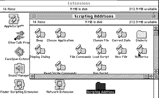

These are all the files it installed: Click to expand...
Hummmmm
That isn't the usual AppleScript installer.
What about in the Extensions folder, did it install "Scripting Additions"?
Oct 22, 2024 - #15
>> phipli said:
What about in the Extensions folder, did it install "Scripting Additions"? Click to expand...
Yes...
1729588742296.png [View]

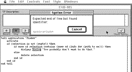

Sadly, it still complains in the same way when I click the Check Syntax button: View attachment 18368 Click to expand...
You spelt "display" incorrectly ;)
Liked by OpualuanandJDW
Oct 22, 2024 - #17
>> phipli said:
You spelt "display" incorrectly Click to expand...
Drat! You're right!
Please accept my humble thanks for spotting my typo!
All is well now. I can save it as an Application. But further testing will need to wait until tomorrow because my brain is thoroughly fried right now. o_O
1729594124519.png [View]

@phipli
Easy Keys works well to invoke the Application saved with AppleScript. CMD-DEL throws the selected file(s) in the Trash without emptying the Trash, which is perfect. I've not tested it on a real vintage Mac yet, but it works perfectly in Mini vMac (Mac II version).
By the way, I replaced Finder 7.1.3 (installed by the AppleScript 1.1 installer) with Finder 7.1.4 and rebooted. CMD-DEL still works. So I guess AppleScript isn't installing a modified Finder. It's just installing Finder 7.1.3 because it's "scriptable" and the installer didn't know about Finder 7.1.4 because it's too new so it prompts you to replace it. Interestingly, the filesize (byte size) is exactly the same when you compare those two Finder files. And I spent 20 minutes in ResEdit looking in vain for the differences. Anyway, the short of it is that you can use either Finder version without issue.
Thanks again!
