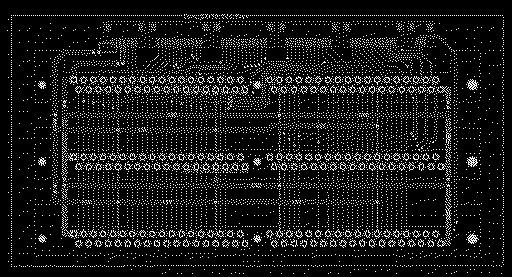

I was thinking, why stop at two simms when you can have three!
The top slot replaces the onboard bank and would only support single rank simms (Dual rank ones will likely just show as half their capacity)
Really this is just a development stop gap, It's the quickest design I could think of to test if relocating the RAM will cause timing issues (though if it can actually be squeezed into the chassis somewhere this may stay as a permanent variant)

I like it, but still wondering how the memory map works out. Did you catch my PM? The Sonora Memory Controller in the LCIII looks to be Apple's first run at the DRAM control line core of the next gen MEMCjr Controller for Q605/LC475 and related to C610 and C650. So you may be headed toward a hooking up a lot more memory than you think. ;)
It'll be four Banks max as in all previous and later versions. Looks to me like you were hitting on three of four cylinders with that 68MB report.
Does anyone know of a utility that can poll memory and report not just how much there is or if it's good, but will indicate how the memory banks are set up and what memory is located where in those banks?

max1zzz
Posts: 269
Likes: 673
May 24, 2022 - #27
>> -SE40- said:
Just wondering if there is a simple vertical connector to replace a simslot. This way it would be easier to expand to memory extension cards ( i call these ) Then it would be simple to plug this card in..... My two cents Click to expand...
Probably! :)
My liking of this approach is for a couple of reasons though, it's more flexible as what's on the end of the cable could be a breakout board as pictured above or it could just be a RAM card with all the RAM soldered on it (Which I like as angled 72pin sim slots are extreamly hard to source in the UK at any kind of sensible price!) but also because if it works it could potentially work in other macs without any modifications (From what @Trash80toG4 said over on 68kmla it sounds like someone has done a very similar mod to the 475 in the past)
That's not to say it's not a approach I would take, it's just not the one I'm taking currently :)

I've looked at the only two(?) types of DIMM modules that support DRAM, they utilize FPM DRAM. Chunking their 64bit data path down to two 32bit memory banks would be like installing a pair of 72pin SIMMs. 72/144 and 100/200 packages exist, dunno how many are out there by now and the latter may have only been used by Sun?
Bounced the DIMM thing off @trag a couple of times and got some roadblocks identified. That was years ago, so all is a bit hazy. At least the 5V->3.3V barrier has been breached to a significant extent I think, IIRC that was but one of the problems.
May 24, 2022 - #29
>> max1zzz said:
it could just be a RAM card with all the RAM soldered on it (Which I like as angled 72pin sim slots are extreamly hard to source in the UK at any kind of sensible price!) Click to expand...
Connectors are always expensive. I say go SMT with SIMMS by beveling the edge at 45 degrees. It should be easy enough for me to come up with a jig for using the Dremel everyone but me seems to have. One part holds the Dremel at that angle and the second would be a slide setup that mates with the Dremel assembly's slide track.
Bolt the SIMM down to the carrier and zip it past the cutting tool. If there's a 45 degree cone shaped milling bit available all the better?
There's another way to go about hooking up a 72pin SIMM sans connector, but assembly's a massive PITA I think. Adds a bit of flexibility for rework as opposed to the bevel/SMT thing.

May 24, 2022 - #30
>> Trash80toG4 said:
Connectors are always expensive. I say go SMT with SIMMS by beveling the edge at 45 degrees. It should be easy enough for me to come up with a jig for using the Dremel everyone but me seems to have. One part holds the Dremel at that angle and the second would be a slide setup that mates with the Dremel assembly's slide track. Click to expand...
I think if we are going that route I would be tempted to have a slot cut on the board, if it was the right width you should be able to get the correct angle on the simms without having to cut them

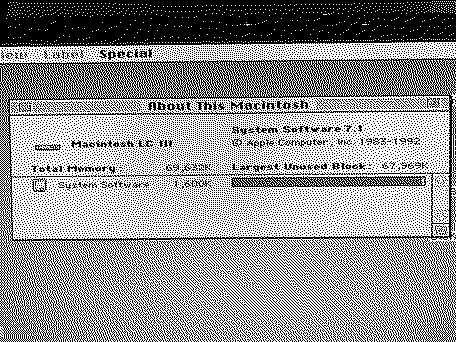

Also I got some new 32MB SIMMS today and can confirm for anyone having doubts that 68MB 100% works:

And the breakout SIMM and triple riser have been sent off to JLCPCB
While i'm waiting for them I'll probably draw up a "direct riser" design too

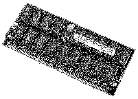

Been away/busy for several months. There is/was a 64MB composite SIMM by HP, 72 pin, that could be useful. It won't get you to 80, but would be a simple way to provide 64 + 4 and only modify the LCIII to the extent of running the RAS lines.
This HP SIMM has 4 banks of 16 on board but uses some logic to make them look like a single bank of 64.
So the SIMM would need modification to get the RAS lines right. Then it would plug directly into the LCIII SIMM slot. Connect the extra RAS lines and Bob's your uncle.
I'll try to better identify the SIMM later. It's about double height so I'm not sure about mechanics.
May be a while. I'm not really back.
These. Other auctions for same thing available first one I found. Should rcheck my facts. Working off old memories. Haven't examined them in ages.

Been away/busy for several months. There is/was a 64MB composite SIMM by HP, 72 pin, that could be useful. It won't get you to 80, but would be a simple way to provide 64 + 4 and only modify the LCIII to the extent of running the RAS lines. This HP SIMM has 4 banks of 16 on board but uses some logic to make them look like a single bank of 64. So the SIMM would need modification to get the RAS lines right. Then it would plug directly into the LCIII SIMM slot. Connect the extra RAS lines and Bob's your uncle. I'll try to better identify the SIMM later. It's about double height so I'm not sure about mechanics. May be a while. I'm not really back. These. Other auctions for same thing available first one I found. Should rcheck my facts. Working off old memories. Haven't examined them in ages. HP A2580-80001 64MB ECC 60ns 72-Pin SIMM Memory Module for 9000 Workstation | eBay Find many great new & used options and get the best deals for HP A2580-80001 64MB ECC 60ns 72-Pin SIMM Memory Module for 9000 Workstation at the best online prices at eBay! Free shipping for many products! www.ebay.com Click to expand...
Very interesting,
That seems a very good way to go and is more closer to what I was originally thinking about doing
Those Simms are had to get over here but I can easily get hold of 4mx4 DRAM IC's so could just design a similar simm assuming there is enough space in the LC case

And a couple of things I have discovered while playing around: The LCIII needs the onboard RAM bank to be present otherwise it produces chimes of death (even with SIMMS in either or both of the other slots) and secondly that onboard bank is limited to 4MB, if you install more it simply doesn't see more than 4MB. This is likely a limitation of the ROMS or maybe of the Sonora it's self
Looks like 68MB will be the limit on the LC III
