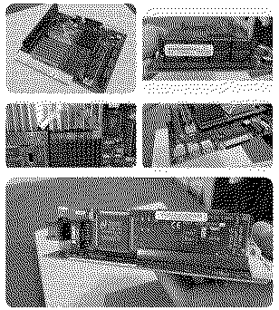

Think a slanted slot would fit on the mobo?

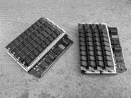

That's a big'un!
Here's a photo of mine that holds them at a slant. Now, these are 30-pin SIMMs, and so wouldn't be suitable for an LC III, but they also made ones for 72-pin SIMMs as well. (These particular ones are "SimmSaver/30" modules, loaded with four 256k SIMMs each.)

If you were able to find an angled SimmSaver/32, it might just work, but I can't make any guarantees!

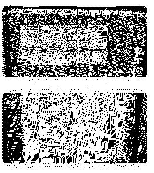

Found a ebay listing with a interesting claim.
this is supposedly a lc-575 logic board in a color classic with the power pc upgrage
here is the interesting bit.
seller says that it is 132mb which is functional under the 6040 but only 36mb is functional under the power pc processor.
