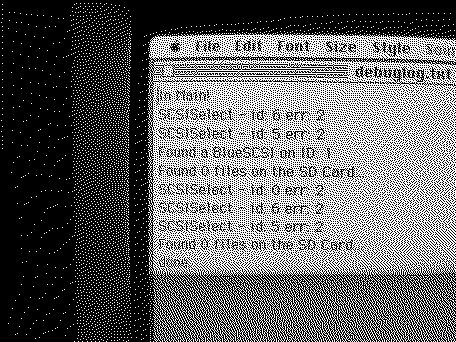

Hi. I have embraced BlueSCSI and think it's amazing, Thanks for your hard work on this! I have a question about the toolbox. I have an SE/30 and a Classic both with internal V2 desktop versions, and a PowerBook 170 with an internal V2 also. I also have a DB25 external V2.
My idea was to create a shared folder on the SD card of the external and then use the toolbox to transfer files from that to the internal blue scsi, however when i run it, it only detects the internal and complains that there is no shared files on it.
I've tried the "Next Device" option in the menu, but it doesnt find the external. This is working fine as the images on it are mounted.
Is it possible to do what im trying to do? I must add, i've only tried this on the SE/30 so far, running 7.5.5
Thanks
Posts: 1,149
Likes: 1,926
Oct 29, 2023 - #14
>> CubeTheory said:
I've tried the "Next Device" option in the menu, but it doesnt find the external. This is working fine as the images on it are mounted. Click to expand...
Does your external BlueSCSI have any drive images on it? At least one image is needed so there's a SCSI ID on the bus to talk to. If that doesn't work please enable debug logging (with the toolbox debug app) then try again, then send me the log from both the external bluescsi and the debug.txt from toolbox.
CubeTheory
Joined: Oct 29, 2023
Posts: 5
Oct 29, 2023 - #15
>> eric said:
Does your external BlueSCSI have any drive images on it? At least one image is needed so there's a SCSI ID on the bus to talk to. If that doesn't work please enable debug logging (with the toolbox debug app) then try again, then send me the log from both the external bluescsi and the debug.txt from toolbox. Click to expand...
Yes. got 2 images mounted, the BlueSCSI PICO W image and the BlueSCSI Toolbox image.
I've just tried it with debugging on. took a screenshot of the output, hope that's ok
I get this when I first start up. there is no shared folder on the internal BlueSCSI, but there is on the external. It only has one file, the stuffit archive for your Wifi App
And when I select device, I get this:
I tried it on the Classic (4mb, running 6.0.8) but the transfer app didn't seem to start up properly. said that no BlueSCSI devices were found on that. The Classic one has a standard Pico on it, and a fairly recent firmware, but not the one with the DaynaPort additions.
The SE/30 is running 7.5.5, and has 16mb and a 32-bit clean Purple ROM

Posts: 1,149
Likes: 1,926
Oct 29, 2023 - #16
You are not on the latest release. The only supported combination is firmware v2023.10.12 and toolbox version 1.0.
CubeTheory
Posts: 5
Oct 29, 2023 - #17
>> eric said:
You are not on the latest release. The only supported combination is firmware v2023.10.12 and toolbox version 1.0. Click to expand...
Ah. That'll be it then [face-palm][male-sign]
I'll update and have another go. will explain why the one in the Classic was undetected too!
I'll report back in a bit
Thanks!
*** EDIT ***
Yes, it works now! thanks!!

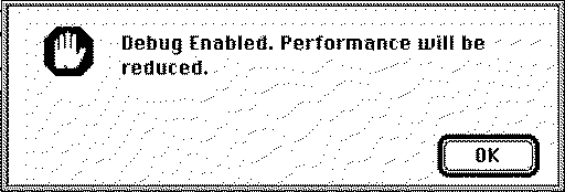

QUESTION #1
The README says:
"Debug Toggle - Used to turn on SCSI debugging. Only use if directed to."
I've only tested the "BlueSCSI Debug Toggle" app within Basilisk II, which of course cannot detect a BlueSCSI. Even though the word "toggle" is in the filename, every time I double-click it, it gives me the same dialog box...
So is it really a "toggle" or is it only an Enable?
And, does Debug mode disable itself automatically when you restart your vintage Mac (with BlueSCSI attached)? (I ask to know how it gets turned off.)
QUESTION #2

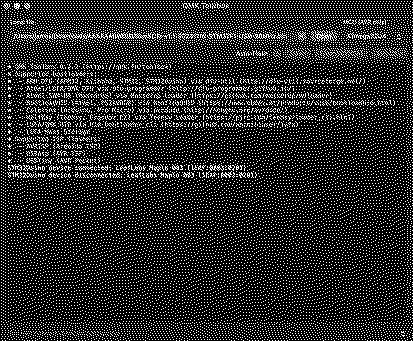

QUESTION #4
I've only ever used flash-mac.command to do firmware updates on my BlueSCSI v1 units, as per this page:
GitHub - erichelgeson/BlueSCSI-Updater: Bootloader & Firmware Updater
Bootloader & Firmware Updater. Contribute to erichelgeson/BlueSCSI-Updater development by creating an account on GitHub.
But per that page's instructions, I downloaded QMK Toolbox.
According to LOG.txt on my SD card, my v1 hardware is: VER: 1.1-20221203-USB-96MHz
(96MHz overclocked WCH clone)
So I downloaded "BlueSCSI-v1.1-20231116-STM32F1-USB-96MHz.bin" from here:
Releases - erichelgeson/BlueSCSI
A small SCSI device based on stm32. Contribute to erichelgeson/BlueSCSI development by creating an account on GitHub.
After that, I did this:
  1. Removed the SD card from my BlueSCSI v1.
  2. Launched QMK Toolbox
  3. Clicked the Open button to select "BlueSCSI-v1.1-20231116-STM32F1-USB-96MHz.bin"
  4. Connected BlueSCSI v1 via USB to my M1 MacBook Pro running macOS Sonoma.
    The RED & GRN LEDs lit and the GRN LED flashed rapidly for a second or so. After that, a line of yellow text saying "...device connected..." appeared. Then after that, the GRN LED stopped flashing for a little bit and a second line of yellow text appeared saying "device disconnected." The RED LED remained lit, but then the GRN LED then started flashing 5 times repeatedly.
I then disconnected the USB cable and inserted my SD card and repeated the above steps. This time, the RED & GRN LEDs light when first connected and the GRN LED flashes rapidly for about a second, and the yellow "connected" text appears. After that the GRN LED turns off completely, and only the RED LED remains lit, and the second line of yellow text appears saying "device disconnected." I've got two known-good cables, so if something is wrong here, I can assure you it is not the cable.
I didn't touch the jumpers on the BlueSCSI or push any buttons at all. Not sure what should be chosen in that popup which says ATmega32U4.
As shown in the screenshot above, the "Flash" and "Clear EEPROM" and "Exit DFU" buttons are always dimmed and are never clickable. That tells me my BlueSCSI v1 was never flashed, nor do I know how to flash it.
Isn't there a step-by-step procedure online somewhere that details exactly what to do when updating the firmware of BlueSCSI v1 via QMK Toolbox on a Mac?

#1 Debug
I cant say how it would behave in Basilisk II, as there is no BlueSCSI attached. This isn't really an issue as I don't see why someone would be trying to enable in an emulator, and also pre the instructions they were not told to :). If you attach it to a real BlueSCSI it will toggle. It will not clear until next power off or next toggle (as you might want to capture logs when booting)
#2 Compressed CD's
Yes you need to decompress files as BlueSCSI just reads the bits from a file. I'm confused on your comment on ID3 - the folder can be any ID, eg: CD1, CD5, etc.
#3 Toolbox versions
That page is for v2 docs. The latest firmware for v1 is required. Please note that v1 does not support CD switching or Debug toggle. The same toolbox transfer app works for both.
#4 Flashing
Click "Auto-Flash" and when it's rapidly flashing it will update the firmware. Rapid flashing is the bootloader waiting to see if you will be flashing for ~2 seconds. Any doc updates are welcome in the wiki.
