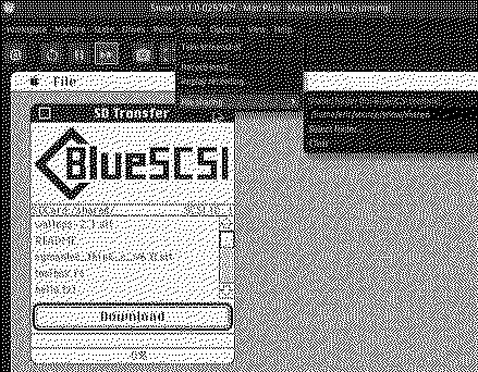

Updated to 1.0.2 - Few bug fixes.
Notable new feature that required no code changes is the SD Transfer app now works in the Snow emulator's bleeding edge build! I actually prepared the 1.0.2 release inside of Snow.

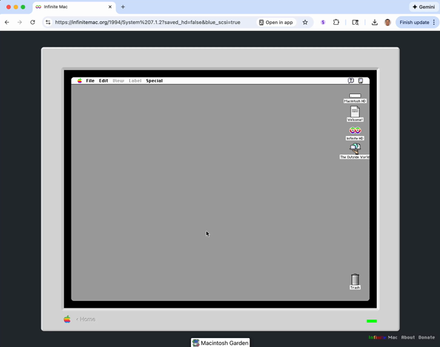

Mihaip and I got BlueSCSI Toolbox working in DingusPPC and now mihaip has it working in Infinite Mac as a way to get files to a machine running dingusppc in IM!
Playing around with adding BlueSCSI Toolbox protocol support to DingusPPC. Though somewhat roundabout, the end result is that you can transfer files in and out of more emulated machine types on Infinite Mac. As a bonus, it also makes the Macintosh Garden library integration work. It works for the 6100 running 7.1.2 ( https://infinitemac.org/1994/System 7.1.2?saved_hd=false&blue_scsi=true ), and you can try to enable it for any other machine via the "Customize..." dialog. Many thanks for @nulleric for @BlueSCSI in general and specifically for fixes to the SD Transfer app and my DingusPPC virtual device (code for the curious: https://github.com/mihaip/dingusppc/commit/6c002e81e58eb336b345bca27973726fd150c139 ). Click to expand...
