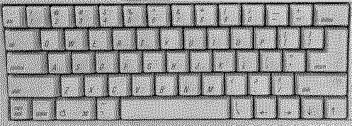

@retr01 I like the keyboard.
Whats the size, where does it come from?
Cost?
398EDE3B-2D66-4B97-93D5-D994033D1901.png [View]
Jun 21, 2022 - #39
LOL @-SE40-! It's the Apple Standard ADB keyboard. :ROFLMAO:
The point is, either you modify it and put it in there without a keyboard case OR go tablet approach. A custom keyboard can be costly. A touch screen is cheaper and can do a bigger touch screen with an adapter (such as a Pico or ) that will translate touch gestures to the ADB, such as the pointer's movement, scrolling, etc. An INIT and cDEV (Control Panel) may need to be programmed for Systems 6 and 7 unless entirely handled on the hardware side and passing on the correct ADB signals. B)(y)

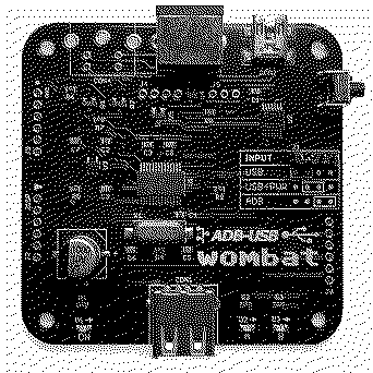

Jun 21, 2022 - #40
This is an example of translating from one input to another for ADB signals from modern keyboards and mice. Thus, it's possible to translate touch to ADB signals.
wombat-top-800-gray.png [View]
