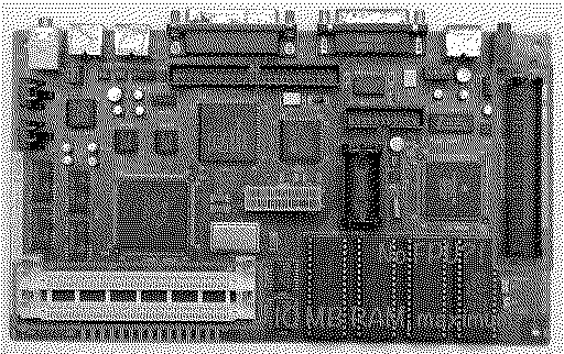

The Classic II board is real compact in its size.
Problably the smallest Apple 68030 board.....(sadly not the fastest)
Combine that with a blue scsi, the display conversion, and a nice display.

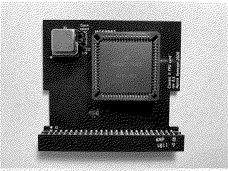

Hey @-SE40-! Good news! A card can be made to add the 68882 FPU to the Mac Classic II! [face-with-party-horn] [hear-no-evil-monkey]
See that this FPU card is perpendicular to the logic board in a regular Classic II case with a right-angle EuroDIN connector of whatever number of pins? Well, swap out for a straight type, resolve clearance and dimensional challenges with the flat floppy disk drive cable and boom! The card could be installed parallel to the logic board. Then, you have an FPU in Hartmut-inspired Classic II Book! :geek:(y):cool:[grinning-face-with-s]

@retr01 ....thats a real nice compact card...
I love that[+1]
Would be able to squeeze that in somehow

Jun 21, 2022 - #14
>> -SE40- said:
@retr01 ....thats a real nice compact card... I love that Would be able to squeeze that in somehow Click to expand...
Yes! And come to think of it, you may be able to add ROM on the card since the slot on the logic board did say "FPU/ROM expansion." [hear-no-evil-monkey]

Jun 21, 2022 - #16
I am looking it up. [eyes]
@-SE40-it looks like a webpage that discusses Classic II ROMDisk using the slot and changing the jumper on the logic board to use the card. So, it is possible to have one card with ROM and FPU.
