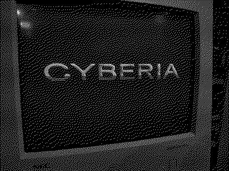

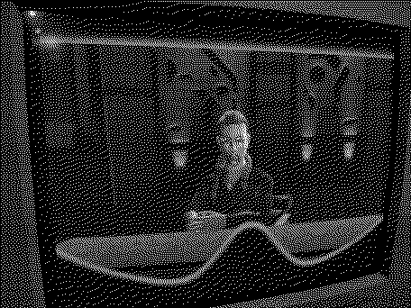

I tested the throughput speed of this by trying it out with video heavy games (FMV) such as Cyberia which comes into a single CD, or even Phantasmagoria (7 CDs, but the first loads well and the intro is watchable). I put them into .ISO format inside the .DSK volume. I used SHSUCDX to mount them as CD-ROM drives, like I do normally with .ISO I copy over. But the kicker this time, is that I can happily let the .ISOs sit outside of my MS-DOS PC machine, unclogging it significantly! (remember, MSDOS hard disk partitions are limited to 2GB and even if you use a modern day uSD card as storage, you'll still be limited to 4x2GB for a total a bit under 8GB of total storage).

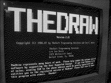

The creator this tool (brutman) is temporarily hosting drives of his own which you can access remotely, for a time, to stress test the internet remote network drive functionality. I went ahead a peeked inside:
I went ahead and ran a bunch of programs, took a nice curated collection of utilities. It feels so wickedly like old times to browse someone else's HD.
(TheDraw is an ANSI drawing/animation program which was often used to produce BBS greet screen or interface menu animations)
