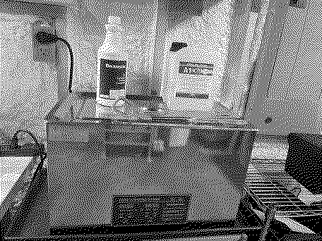

My VEVOR 30L Ultrasonic Cleaner is approaching 4 years of sporadic use and I'm doing a water change now so I thought it might be interesting to create a thread to share my experience and hopefully hear from others too. Let's share recommendations, tips and tricks!

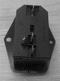

  1. Faulty power switch
  2. Leaky drain valve
When it was about a year old I went to use it one weekend and I could not turn it on, physically. The rocker power switch on the back would not move. I took it apart enough to look at the switch, the mains wires showed definite signs of overheating. Opening it up, it clearly overheated enough to melt the plastic within the switch, fusing it in the off position from when I turned it off after last using it. :( I replaced the switch and its been working okay since. Maybe just a random faulty part?

As others have noted the "30L" size seems to be like the old "15 Inch" CRT monitor marketing (13.3 inch viewable!). I've used 6 gallons (22.7L) of distilled water which is as close to the top as makes sense to me (~3/4 inch). Using distilled water at least starts you off without any minerals and impurities that might be in your tap water. Although after a while I wonder how that would compare to what comes off what you are cleaning...
For cleaning solution, up until now I have used "Elmasonic 800 0102 Elma TEC Clean A1 Ultrasonic Cleaner Solution Concentrate for Electronics and Optics" Its $113 for 2.6 Quarts (2.5L) on Amazon (10/27/2024):
https://www.amazon.com/gp/product/B0725WP9Z9/?th=1
The Elma instructions recommended using 3-10% of the water, I used 3%, 23 fl oz (681mL).
However, this go around I've decide to give Branson EC a try as it seems highly recommended. I ended up getting it off eBay, "Branson EC Concentrate Circuit Board PCB Ultrasonic Cleaning Cleaner Solution", $70 for 1 Quart (950mL). Pricier than the Elma.
https://www.ebay.com/itm/185929230724
The Branson instructions say to use 2-5% by volume, with 3% recommended. Which I'm just about to do (anyone go higher or lower with this stuff?).
