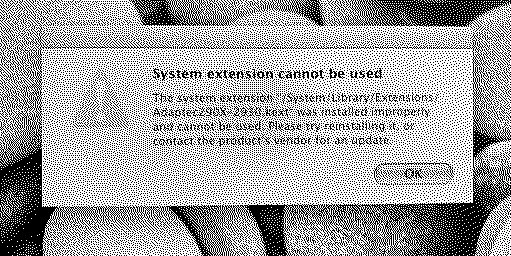

I knew Leopard may be pushing things, but I figured I'd try. Without drivers the "PCI Cards" section of the Apple System Profiler showed that no driver was installed for the SCSI Card. So I downloaded the v1.1 (Feb 2002) driver and attempted to install it, but the installation failed. I tried to be smart and install the driver manually, but that resulted in a lovely error upon startup.

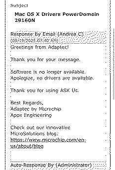

Does anyone have a copy of the Mac OS X drivers for the 299160N SCSI to share?
The file is: apd29160x_X_v12a.hqx.
The downloads for it on Adaptec's site are all dead :( and support would not provide it.
I also tried the Wayback Machine, but I couldn't get a download either.

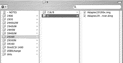

This may help, @Ron's Computer Videos did a great video and journey of archiving a lot of Adaptec drivers, including the 29160, you can check it out here: https://macintoshgarden.org/apps/adaptec-powerdomain-scsi-card-firmware
It looks like it may have something similar to what you need.
Note: TheUnarchiver didn't like to unpack the .sit file on my particular system, but it unpacked fine on my G4 Mac with StuffIt Expander 8.x.
