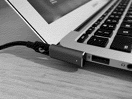

I recently learned about the existence of USB-C Power Delivery to MagSafe 1 adapters and cables, and decided to give one a shot. At only about 5EUR delivered to me, I didn't have much to lose. I liked that it's just a small adapter that I can just leave connected to the Mac, and not an entire cable.
At first, it didn't seem to fit at all. I thought it was an inner diameter tolerance issue, but it turned out to be a stuck pogo pin that was causing it to not sit in place properly. I used a bit in my iFixIt driver kit to force the pin down (with a pop), and it now springs in and out almost properly. It does extend slightly less than the other pins.
On plugging the adapter into a USB-C Power Delivery power supply that supplies up to 20 volts, the USB-C to MagSafe 1 adapter seems to immediately request 20v, and uses about 0.1 amps. My concern is that instead of sensing a load before providing the full 20 volts, the adapter seems to always supply 20v out of the pins, which can cause arcing and shorting. That's not great. I can't measure it with a multimeter to be sure, as I'd surely arc and ground things. No thanks!

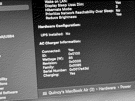

Here's what my MacBook Air thinks is connected:
If the MacBook determines which power adapter is connected by measuring the input voltage, then it makes perfect sense that it would see 20 volts, and determine that an 85 watt power supply is connected. This leads me to believe that supplying 20 volts to a 2011 MacBook Air is fine.
