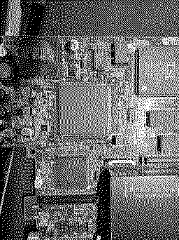

Can it be done?
I tried installing MC68040FE33V but no chime. CPU gets warm so it does something? Soldered LC back, works again.
Does the ROM care about it? They are pin compatible and the only difference should be FPU?

I recall reading somewhere about someone else doing this successfully, ...and something about only specific CPU part numbers working in Macs. Was it a 5V vs 3.3V thing?
PowerBook 500 Series full 040 CPU swap
You definitely should! I'm guessing this mod could be applied to the 190 and the Duo 280c. I was thinking that too.. actually I'm thinking if you took a 190 and replaced its screen with an active one from a 5300 (maybe even a CE?) and gave it a full 68040 you'd pretty much have the best...
I think these are saying you need one of these:
MC68040FE25A
MC68040FE33A
MC68040FE40A
and that the ends in V version actually doesn't have an FPU and is 3.3V not 5V.

I have successfully done it on a PowerBook 540c and a PowerBook Duo 280c. @croissantking is the first I saw do it successfully (the above link is to his thread) on his 540c which is what inspired me.
Never tried on a 190.

Ah crap. It looks like V is 3.3V part. So I probably fried it a bit ;-)
I guess I need to find 5V part and try again.

>> DominBear said:
Ah crap. It looks like V is 3.3V part. So I probably fried it a bit ;-) I guess I need to find 5V part and try again. Click to expand...
It may not have burned as it can accept 5V input, though VCC should be 3.3V.
However V part don't have FPU - even if they are not labelled LC.
Quoting appendix C of the '040 UM:
* For the MC68040V, all differences that exist between the MC68LC040 and the MC68040, as described in Appendix A MC68LC040, also apply to the MC68040V. For the MC68EC040V, all differences that exist between the MC68EC040 and the MC68040, as described in Appendix B MC68EC040, also apply to the MC68EC040V. * Both devices operate to 0 Hz and can accept 3.3V or 5V input. Click to expand...
They also have three extra signals so the pinouts is not 100% identical to non-V in QFP packages.

>> Fizzbinn said:
I think these are saying you need one of these: MC68040FE25A MC68040FE33A MC68040FE40A Click to expand...
Yes, those are the correct part numbers for the K63H and L88M masks.
E42K is MC68040FExx (no suffix)
E31F is XC68040FExxM
Genuine chips also have their speed rating printed under the part number eg '66/33 MHz'.
Here are some examples:
>> Fizzbinn said:
and that the ends in V version actually doesn't have an FPU and is 3.3V not 5V. Click to expand...
Yes, this is correct - no FPU.
A valiant effort OP - I don't think anyone has done the FPU upgrade on a 190 yet.

Well round 2. My Amazon 68040 purchase from China has arrived. Soldered the CPU, it booted couple times. Ran Tattletech and Speedometer.
Neither reported FPU present. Then after Speedometer benchmark wchich returned the same results as before, the machine froze and didnt boot again anymore. So I guess I got a rebadged LC and 25MHz one that probably fried itself.

>> DominBear said:
I kind of like the trackpad. Click to expand...
They're OK if you accept them for what they are, but they cannot compete with modern trackpads.
>> DominBear said:
Well round 2. My Amazon 68040 purchase from China has arrived. Soldered the CPU, it booted couple times. Ran Tattletech and Speedometer. Neither reported FPU present. Then after Speedometer benchmark wchich returned the same results as before, the machine froze and didnt boot again anymore. So I guess I got a rebadged LC and 25MHz one that probably fried itself. Click to expand...
Beware fakes! They're everywhere!
Finding a genuine 68040 is quite difficult, from what I've read, and many so-called 66/33 '040s with FPUs are actually fraudulently remarked 25/50 68LC040s. Many of those were probably cooked almost to death when they were reclaimed and remarked, too, so if one tried to use one, it either would work for a short time and then fail (as yours did) or be DOA and not work at all.
There are one or two reputable sources that I'm aware of (new reliable sources get discovered from time to time, but they usually go out of stock fairly quickly because their inventories are usually fairly small). The costs are often higher, sometimes significantly, but you do get what you pay for, because they're usually either genuine NOS, or carefully salvaged REAL chips that have been tested to ensure that they operate as advertised.
