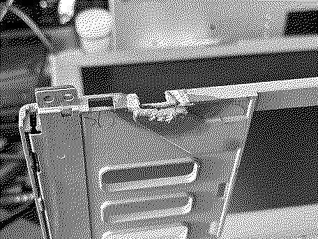

This is the worst battery leakage I've come across in a laptop thus far (worst overall goes to my poor Psion Revo which had chunks of acid living inside it).

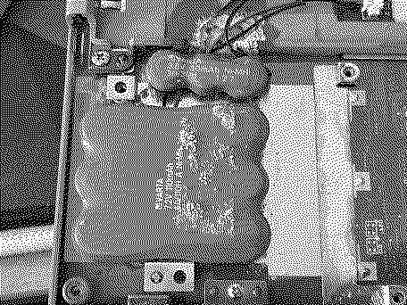

This 12-cell monster is probably to blame for the sheer volume of acid. These are used to keep the laptop powered while in sleep mode with the main battery removed, which allowed you to "hot-swap" the main battery with another one and continue working on-the-go. Great for road warriors in the 90s, not so great for retro computing enthusiasts who have to deal with the acidic aftermath.

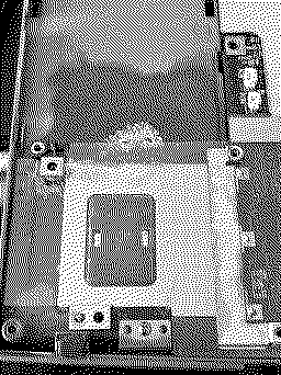

Miraculously, the RAM expansion module (it has 32MB soldered on the logic board) dodged the acid spilling out right next to it.

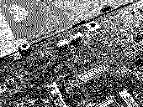

The logic board seems to have dodged most of it too. Usually the acid glues these connectors together but after soaking in vinegar and some "careful" prying, they came out undamaged.

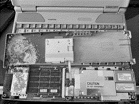

The acid had spread underneath the cursor buttons - thankfully both the contacts and the buttons themselves were unharmed.
The chassis looks to have sponged up most of the spillage.

You got hit by the megavarta!
It's actually 6 huge cells in there - here's a photo of one opened that was somehow only JUST starting to leak.
Good luck getting that laptop running again.
