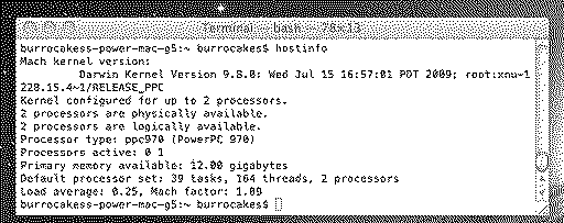

Mar 22, 2023 - #3
I use hostinfo in terminal
or machine to find cpu type.
hostinfo Terminal1.jpg [View]

@Certificate of Excellence hostinfo does only give a translation of "subtype" ... so 7400 - even if it's a 7447a. Will have a look at machine.

Yep, my suggestions fall short of what you are looking for. Best of luck to you. :)
