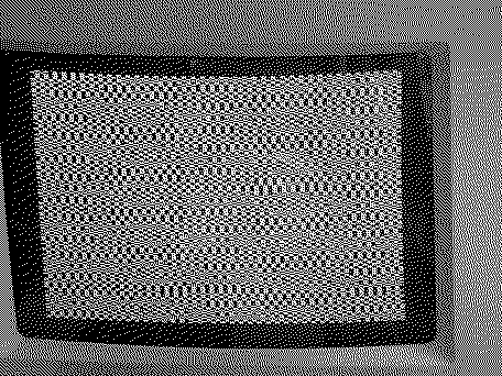

Now the bad news. While the seller showed a picture of it booting to a IIgs blue boot screen, I have not had any luck getting it to show anything but a weird black and white pattern on the screen.
[Image: IMG_9853.jpeg]
It doesn't seem like doing a reset does anything helpful. Any ideas on where I need to start? I verified the dip switches were correct on the accelerator card. And I tried with and without the memory expansion card. I haven't tested the PSU voltages yet but will do so. I also can't test without the accelerator because I don't have the original CPU.

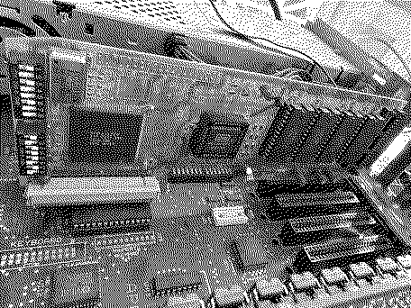

I cleaned the board and replaced 4 caps that I had replacements for on hand. No change.
I pulled out my known working IIgs and decided to confirm the ROM and CPU accelerator were working, and they do. When I put the known good stock CPU and ROM, I get the checkerboard pattern still. Also swapped out the other socketed chip - 343-0051. I also swapped in a recapped PSU, even though the voltages looked good, just to be safe. No change. So it's definitely something else on the main board. I'm going to take a closer look at the sockets - maybe the ROM or CPU sockets are bad, but that seems unlikely.
It seems as thought the reset pin (pin 40 on the CPU is being held high, which I believe it wrong. I see it briefly drop when I hit reset on the keyboard.
