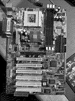

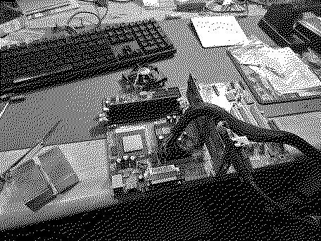

To start out, the TUSL2-C sadly wasn't in working condition, it needed some work done to it. Thankfully it wasn't severe, all the Nichicon caps had popped, but the Rubycon and Sanyo caps were perfectly fine. So in interest of not having to deal with ground planes any longer than necessary I...just removed the Nichicons and replaced them with Rubycons. Job done, build can proceed...or so I thought.
While the whole thing worked great, what I ended up noticing was that my PS/2 keyboard was becoming incredibly flaky, before eventually just giving out entirely. I thought I'd have to do a viking funeral for my Model M, but cross checking this with another keyboard that I knew 100% to work, it was dead too.
Turns out there's a little component that tends to go bad on these boards, as per Vogons, and it needs to be removed. It's this little C151, pictured here:
This, sadly, is not for the feint of heart. I have a microscope and a fair bit of experience doing this and I struggled a fair bit to get enough heat onto the board to get that little bugger off without disturbing anything else. I actually ended up knocking off a few of the surrounding components but was able to get them back into place and the board is thankfully unharmed and working as normal again.
