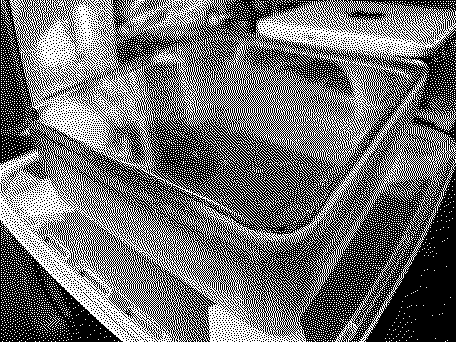

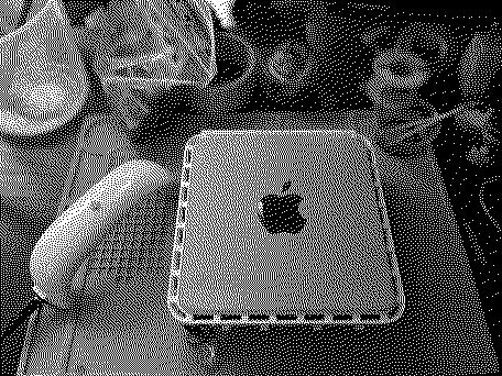

Here are some other angles of it

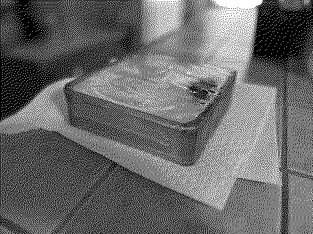

and here's why the top is foggy, where I struggled with the initial pour, there are dents I could not sand out without sanding the rest too far

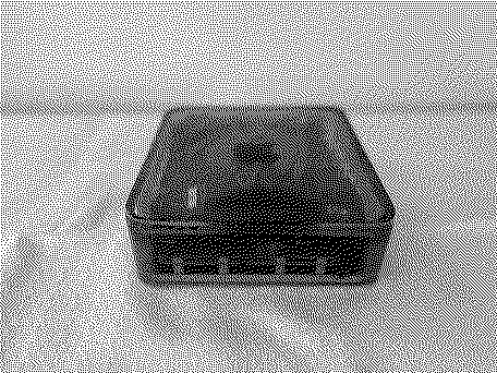

after another pour:

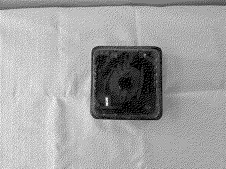

and here is where the apple logo comes from

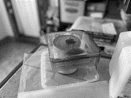

and the final coat of resin after gluing the logo on
