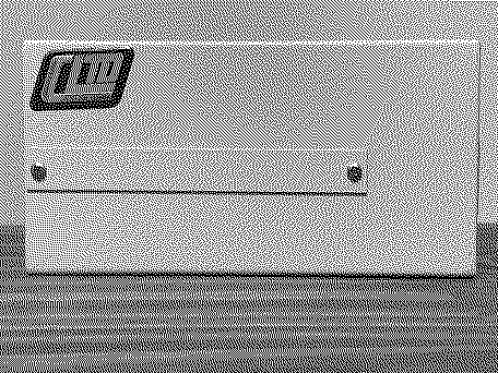

I own a C.Ltd SCSI-1000. It's in a metal enclosure, and the front has a really nice metal badge.
Is it too late to send in the warranty card? (Ha ha!) The back shows that this is revision 1.2, and serial number 91E2396. I'm not sure if this means that they made at least 2396 of these (as they could have started the serial numbers at 1000 or 2000), but they definitely seem like a small business, as the label appears to be photocopied with a hand-written serial number.

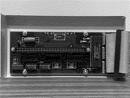

The obligatory inside shot, because folks are going to ask for it anyways. That liquid is Deoxit residue, and the single electrolytic capacitor has been replaced.
The SCSI chip is an AMD AM5380PC.

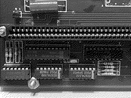

Under the SCSI chip, the PCB is labeled:
C-LTD BRECK RICKETTS
REV 3
It looks like a "3", but it could be a "B". (It's hard to read even in-person.) But given what looks like a roman numeral III on the PCB itself, I'm inclined to go with "3".
In case anyone is wondering what the rest of the logic chips are. Other than the SCSI chip and the one PAL pictured here, the rest of the ICs are standard jellybean logic chips.
And yes, if you looked at the photos of the SCSI-1000 on Big Book of Amiga Hardware, you'll notice that I am missing the card edge that would let me daisy-chain another sidecar to this one. (It looks like a passive PCB, so one could be fabricated, assuming someone hasn't already done it.) You will also notice that there is a ribbon cable in this enclosure. I have no idea why, unless it was for a terminator, as that's the only thing at the time that would have fit. (It's possible one could fit a Blue SCSI with a right-angle header, but it might block the bus pass-through connector.)
