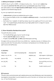

The following info from ChatGPT needs to be vetted, but it does make sense...

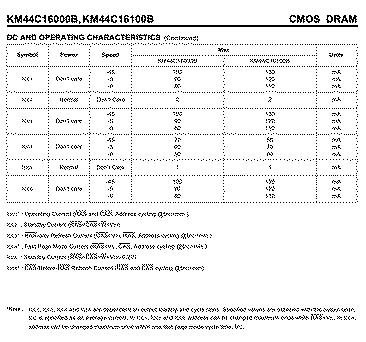

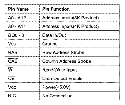

And here are excerpts from the "KM44C16000.pdf" datasheet kindly provided by @trag that seems to confirm that chip currents are not pulled through the Address lines...
