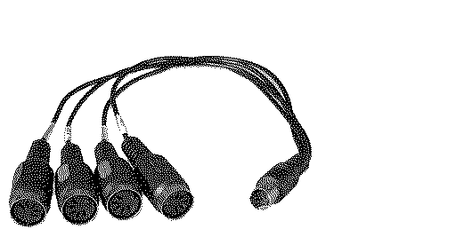

Citing MIDI in that small box was hard and the BOM was going a little crazy (need other switches, opto couplers and probably Mini DIN to DIN adapters such as this one

MIDI-Breakout-Cable.jpg [View]
