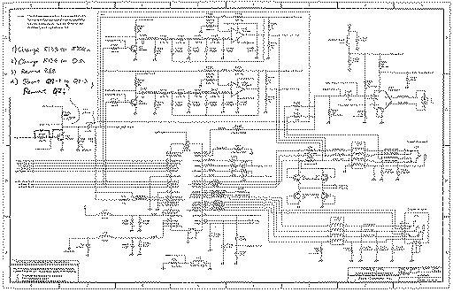

After looking at the Quadra 605 schematic again and comparing to the recapping list, every single replaced capacitor is a filter capacitor. 4 of them are used to smooth out the power signals the sound chip uses, yes, but these are still used to shunt power supply noise to ground. What I see of testing audio capacitors, they are part of the analog input/output circuit, not part of the power handling circuit, so I'd expect the ones we care about to be more forgiving and have noise levels that are still quite low as a result.

>> Nycturne said:
I honestly expect that it's the 22kHz sample rate that is the bigger contributor to the "low-end audio" sound out of 68k Macs. Having your DAC's low pass filter cut off everything above 11kHz will make things sound a bit flat. Click to expand...
Exactly.
So even if you were to connect some really fabulous audiophile-grade speakers to the headphone jack on your Mac, the audio the Mac produces is still limited by that sampling rate. That's why I don't think it would matter if you replaced all the caps in the audio circuit with tantalums, which often goes against the best advice from the audio gurus.

After looking at the Quadra 605 schematic again and comparing to the recapping list, every single replaced capacitor is a filter capacitor . 4 of them are used to smooth out the power signals the sound chip uses, yes, but these are still used to shunt power supply noise to ground. What I see of testing audio capacitors, they are part of the analog input/output circuit, not part of the power handling circuit, so I'd expect the ones we care about to be more forgiving and have noise levels that are still quite low as a result. Click to expand...
For others reading this thread, here is the audio page from the Q605 schematic:
