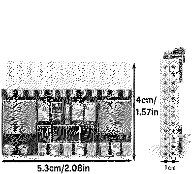

I've identified available cubic in the TAM for boosting its anemic power budget in the upper right hand corner of the red box:
edit: found a far better pic of available cubic:
A PicoPSU will fit nicely mounted vertically to edge of the ComSlot2 standard riser with hot glue or socketed on a custom repro riser.
Power supplied to the rails of a SATA Connector are a question mark, maybe, maybe not able to drive two PCI Cards off the cable?
ATX connector may be required as source for slots?
PicoPSU in 90W range seem expensive ($100+-) while 150W units seem to be very inexpensive in comparison.

Haven't got the TAM DevNote handy, but we're talking about duplicating or improving upon the 6500 expansion card power budget.
WAG for the time being is that PicoPSU waste heat will be proportional to power drawn by the three expansion cards?
- if so, would it make a difference if 90W or 150W max output PicoPSU is used in terms of cooling requirements?
Dunno, thoughts?

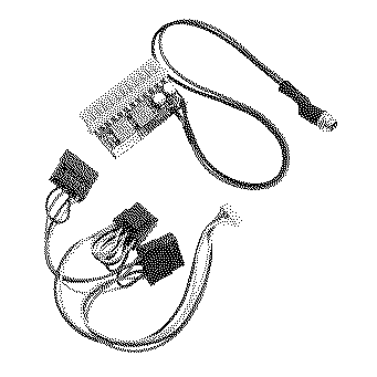

Jun 26, 2024 - #5
Lots of activity on the PSU front for 6500 recently and in the far distant past.
Some 14 years ago I was looking into 6500 and Beige G3 ATX conversions. Going for an ersatz TAM/FatBack form factor build now that will be powered entirely by the 250w PicoPSU pictured above.
In his discontinued mAcATX project, blusnowkitty posted his concept for a Q630 version:
That gets me halfway there, 3.3v required for PCI in the 6360 and Gazell machines. I don't need the soft power circuitry as I'll be using a wireless USB KBD/Mouse combo. Hoping to do the conversion in cable by rearranging Molex pins on a 24pin->14pin adapter cabl.for KISS principle adherence. I cannot imagine Apple went with an ATX compatible connection? Assumption would be that a simple ATX PSU startup button switch will suffice? Wondering if such is part of the PicoPSU spec?
This pair of adapter cables are incoming, figuring I'll need wires from the second adapter to do a full 14pin 6360/TAM implementation?
For nearer term project I only need to power the TwinSlot adapter to allow use of a power hungry pair of PCI cards in the TAM. That'll be done on the Dummy CSII riser pictured above. That project will eventually include connections to implement the (ofttimes missing?) standard TAM riser as a bonus feature.
Help definitely needed here. Might a dedicated ATX PSU conversion for these machines topic be better? Anyone have linkage to such things?
