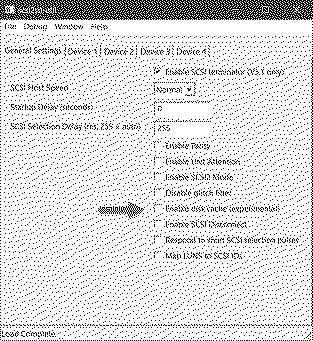

You may be able to prevent this from happening in the future with a tweak to your SCSI2SD settings. In case you haven't already, make sure you have "Enable Disk Cache" disabled.

Update - I verified the cache setting in the SCSI2SD firmware. It was not enabled so that was not the culprit, but here's the setting to ensure this is documented for others.
