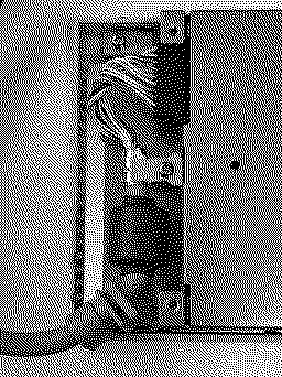

I would like the share my recent experience and observations with 3.5" 800K floppy drive head alignment.
As probably mentioned before the The Dead Mac Scrolls offers a great problem and solution list to go through with alignment fixes being the last resort.
In my case it was definitely alignment of the optical sensor. The interesting thing that I found out, that I haven't seen mentioned anywhere else, is that it seems to be easier to get the floppy drives to work using the cable from an external 3.5" drive than the ribbon cable in the Macs.
The external drive cable is very well made with the foil shield only connected to shield ground and a ferrite bead. I didn't double check how they pair the wires in the cable, but maybe they pair grounds with signals as well to reduce crosstalk within the cable.
With the external drive cable I was able to get both 800K drives to read and write disks. With the internal ribbon cable the drives could almost boot from one disk and not at all with another.
It might be interesting to try to make a new rounded ribbon cable for internal drive connection and see if the same results are achieved. Maybe a parallel port cable would do the job.
Other observations I made is that it seems if the drive's optical sensor is misaligned, disks can either not initialize at all or they can initialize and then be read afterwards, but then have trouble in other drives. I'm assuming the difference is due to the level of misalignment of the optical sensor.
