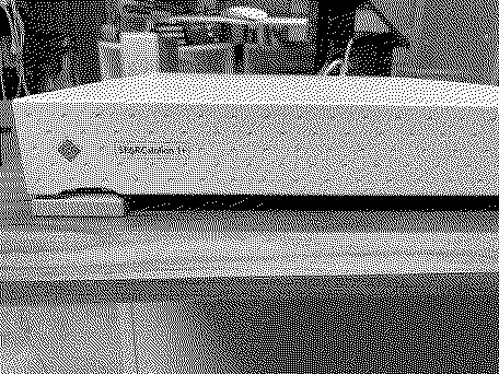

The answer in this particular case was Xylene!
IF the parts fit together tightly, just hold them together and use a fine modelers brush to let capillary action draw the adhesive into the crack. Sets within a minute, and basically as strong as the unbroken plastic within 20 minutes or so.
Not suitable for areas with gaps, but if the fit is tight, it works great - at least on Sun Microsystems cases like a Sparcstation 1+ and an Ultra 1.

May 2, 2024 - #5
>> ScutBoy said:
The answer in this particular case was Xylene! View attachment 9050 View attachment 9051 IF the parts fit together tightly, just hold them together and use a fine modelers brush to let capillary action draw the adhesive into the crack. Sets within a minute, and basically as strong as the unbroken plastic within 20 minutes or so. Not suitable for areas with gaps, but if the fit is tight, it works great - at least on Sun Microsystems cases like a Sparcstation 1+ and an Ultra 1. Click to expand...
Damn - that is a very nice repair - barely notice the crack line!
