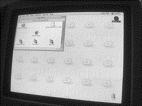

In the mean time I found a box of HDD in the corner of my workshop and low and behold there was a Maxtor IDE spinner in there which is now in the iMac with a fresh install of OS.9.1. These machines are really quiet (its my first iMac CRT and came out after I left the Apple reseller outlet I ran).
