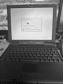

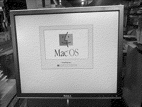

I just burned a CD and the classic mac OS won't mount it still. My PowerBook 3400 couldn't read it (old optical drives have issues sometimes with burned disks). I tried a clamshell and it gave the same error about it being uninitialized, thinking it's a 0K ProDOS image. Disc reads under OS X...
Posts: 669
May 20, 2023 - #14
Ok what the heck? It just mounted fine under OS 9.2.2 on my TiBook. Methinks I have some picky optical drives.
Posts: 669
May 20, 2023 - #15
Got it copied off to a bootable CF card for the PCMCIA slot in the end and it's working. That was a process.
