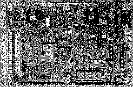

I recently bought an old SIMCheck II in the hopes that it'd be possible to clone for hobby use. I guess the inventor was very concerned about cloning when the device was new, because many of its ICs (even jellybean logic) have their silk screens sanded off. Further, there's an Altera CPLD present. I haven't checked yet, but would be really surprised if its security bit was not enabled. Perhaps that could be brute forced with something like the DuPAL, but that's an area I'm not familiar with.
For now here are a couple of board shots and an IC list of what's known on the 'processing board'.
Also, my unit has firmware 1.52. I'll try to dump and post that. The latest firmware is 1.55. If you have one of these units with newer firmware, it'd be much appreciated if you could dump and post it.
SIMCheck II Processing Board

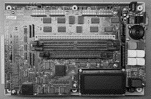

SIMCheck II SIMM Board
Processing Board Semiconductor List
U1: TX486DLC/E-40GA CPU
U2/U3: Unknown
U4/U5/U6: Unknown
U7/U8/U9: Unknown
U10: Unknown
U11: ADM-692AM MicroprocessorSupervisory Circuits
U12: MIC29150 Voltage Regulator
U13: Unknown
U14/U15: 74ACT00PC Quad 2-Input NAND Gate
U16: EPM1032LC44-10 Altera Max 7000 programmable logic
U17: Unknown
U18: Unpopulated
U19/U20: AM29F010-90PC 1MBit CMOS 5V Flash Memory
U21/U22: W24257AK-15 32Kx8 HIGH SPEED CMOS STATIC RAM
U23: MAX232CPE Serial Driver
U24: SCC2691AC1N24 UART
U25: D71059C-10 Interrupt Control Unit
U26: D71055C-10 CMOS Parallel Interface Unit
U27: D71054C-10 CMOS Programable Timer/Counter
U28: MC74HC174AN CMOS Hex D Flip-Flop with Common Clock and Reset
U29: MM74HC244N Octal 3-State Buffer
U30: Unknown
U31: 317T Voltage Regulator
U32: LM317 Voltage Regulator
U33: Unknown
U34: LX8385 Low Dropout Positive Regulator
U35: Unknown
U36: Unknown
U37: CD54HC377E High-Speed CMOS Logic Octal D-Type Flip-Flop With Data Enable
U38: 24C01A 1K Serial EEPROM
U39: Unpopulated
U40: 74ACQ244PC Quiet Series Octal Buffer/Line Driver with 3-STATE Outputs

IMG_6503 3.jpeg [View]
IMG_6490 2.jpeg [View]

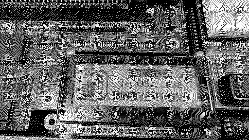

Those long dip20's may very well be SRAM as my original SIMCHECK I used two SRAM chips for main system memory.
Either that or 20V8 GAL chips. I bet the retro chip tester dould identify them. Also looks like the SOIC packages next to the CPU are 74 Series logic, 74xx245 or similar
