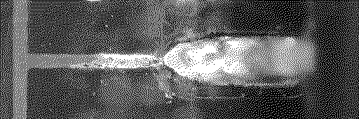

I measured the oscillator (Y2) and noticed it was only active when I pressed down. I replaced Y2 without improvement. I carefully measured everything going into Y2, and discovered power (5V) disconnected and reconnected when I pressed down, but power at the main motherboard connector stayed solid. Ah ha! A cracked trace or component leading to Y2.
By measuring the continuity each step of the way until Y2, I found inductor L13 was cracked at one end. I replaced it from a battery bombed SE/30.

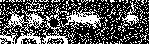

Then, I learned something wonderful. I never knew the 68030 walked the address space, and in doing so, provides easy to follow frequencies to detect broken or shorted address lines. Thank you Simasima Repair Guide page 46.
Carefully measuring them revealed address lines A12 and A5 were combined. Nothing is going to work with bad address lines. Consulting the Bomarc schematic, I found that A12 and A5 are used on video chip UB8. That's one of the areas I reflowed lazily.
Turning the board upside down revealed a solder bridge. Solder flowed out the bottom of a hole and bridged to the next hole. Oops.
Removing the blob with desoldering braid resulted in a happy Mac chime!

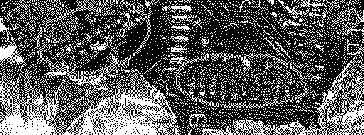

3. Double vision. Multiple images.
What the what?
Multiple copies of the startup icon and mouse cursor appear on the screen. Lots of flicker. However, the horizontal and vertical size and placement of the screen is good. And, the images aren't stretched or condensed.
Fortunately, a post on the other forum by @KhanTyranitar and @Bolle provided a really strong clue.
SE/30 double image
Ok this is on an SE/30 that I've been trying to get working for a while. I took it to JJ Dasher and he was able to get it to this point. It does boot to the finder. But at every stage it has this weird double image thing going on. Has anyone encountered this before. Before anyone asks, yes...
Pins 2 and 14 are shared for UA8, UB8, UC8, and UD8. On my motherboard, there was an imperceptible break in the trace for pin 2 of UB8.
Adding a small wire to connect the trace fixed the multiple image problem.
