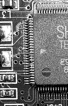

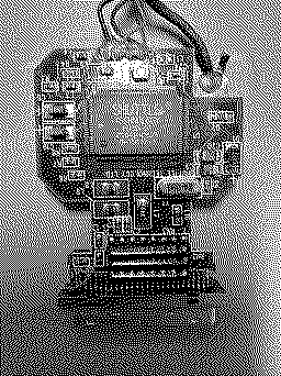

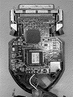

With asking prices for these adapters being kind of absurd, I figured it might be helpful to consider reverse engineering one. It seems like a couple of special purpose ICs, a ROM and a surprising amount of passives. I don't think I'm up for the challenge of reverse engineering it, but figured some photos and IC info might be helpful if someone else wants to try.
The main ICs are Shuttle EUSB-01 & Shuttle EUSB-S1. I couldn't find data sheets for these. Please post them here if you can.
I'm also not sure of the ROM size, but will dump it if there's interest.

At a guess, this is a rebadged SCSI controller chip plus microcontroller. Having the ROM dumped is a step toward figuring out which architecture the CPU is.

I suspect that they're bit-banging out SCSI from the EZUSB chip(s) much like BlueSCSI, RaSCSI, and SCSI2SD do, just in reverse. The BlueSCSI hardware could probably be reprogrammed to pass SCSI data in & out the USB port if someone finds a good driver interface to copy. I don't think there is anything extra besides a different firmware to act as a SCSI initiator instead of a target.

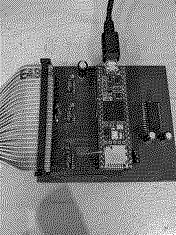

Just stumbled over a separate project trying to design and actually implement a low cost USB to SCSI adapter based on a teensy board here:
https://github.com/svenschnelle/teensyscsi
While the last update was done three years ago, there is already quite some amount of code. Actually the amount of code is a rather impressive!
There is also an accompanying thread by its developer on a German retro computing board here:
https://forum.classic-computing.de/forum/index.php?thread/24720-low-cost-usb-scsi-adapter/
Apparently the developer has already created fully working prototypes in actual hardware. And since his needs have been covered no further work seems to be done anymore. He claims that this adapter is able to read/write from/to a MO drive and hard disks.
A low resolution photo from above mentioned forum thread has been attached.
