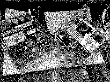

I split the PSU open and found something interesting. All the cables break up into 3 distinct groups. One small cluster attaches to the upper board alongside the high-voltage side. One group of fairly thing wires attaches to a riser board on a plug. The remainder (all 12V and ground as far as I can see) all link to the main lower PCB directly.
This would indicate to me that the three areas correspond to the three present voltages. It makes sense the large low-voltage section would control the 12V as it makes up the bulk of the power capacity. The two smaller sections would thus be 3.3V and 5V I think.
