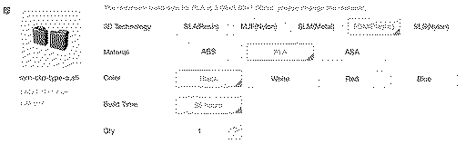

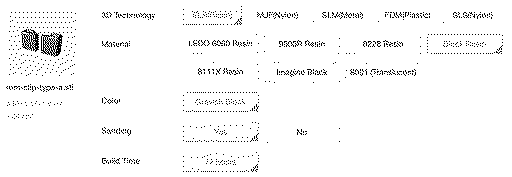

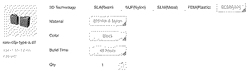

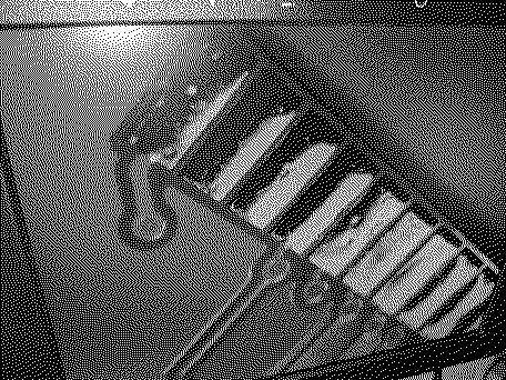

Forgive me, Colin, one quick question. You didn't mention "Resin." Would Resin/SLA be just as suitable for these ROM Clips as an FDM like PLA/ABS/ASA?
The reason I ask is because JLCPCB's 3D printing service complains the ROM Clips are too small for FDM printing!
I am able to choose from various Resins (which offer "Sanding")...
As well as SLS or MJF Nylons...

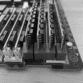

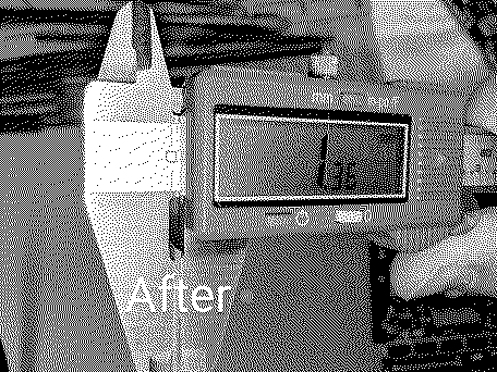

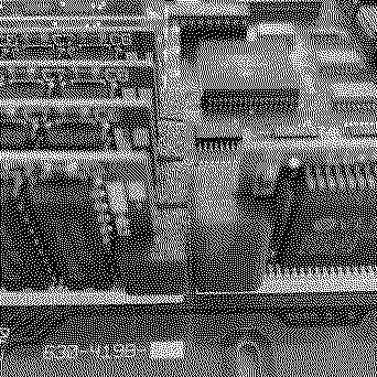

Sep 16, 2023 - #16
I added solder to one side this morning. It brought the thickness very close to my stock ROM Simm that has 1.38mm, so I got 1.36mm with the BMOW Simm (from 1.20 mm).
The ROM socket doesn't give great confidence at its age that it even holds the stock one well anymore, let alone the BMOW one (no satisfying click anymore) so I'm 70% happy with this. With both stock and new, I seldom get bad contact and get this gray pattern with some light randomness (not a checkerboard, it's hard to describe).
But I got it stable enough for my needs with the case in. Now that I have a RGBtohdmi set of cables out of the J12 connector, removing and installing the case is added small pain.
I'll probably go the clip route one-day when I get the opportunity to see my friend with a printer.
