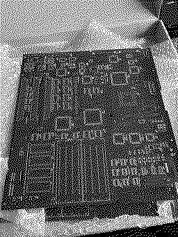

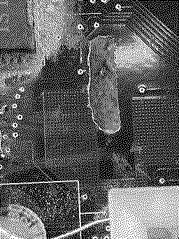

It's time for another one!
The LC II went much quicker than expected so it's time to start on a board I have been looking at for a while - the IIcx
The IIcx in question was actually purchased as a repair project until I noticed the board had layer marks, and to my surprise it was a 4 layer board!
We all know what that means:
Top layer traces are done, and man this thing has a lot of traces and VIA's!
And a special thanks to @Kai Robinson who managed to figure out how to get sprint to load the board scans which it initially refused to (Turns out Sprint has a size limit when loading colour images which very large boards exceede, converting the image to grayscale avoids this issue)

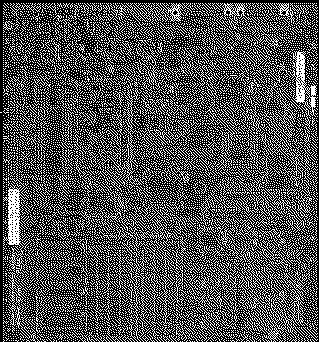

Annnd 17 days later:
This thing is going to take ages to assemble....
And it just occurred to me I forgot to order the axial 'lytics.... Hopefully I have radials in the appropriate values

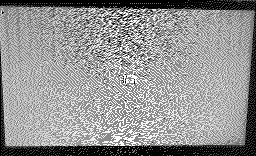

On testing this I got.... Nothing. The PSU didn't even start up (and yes I did remember to fit that missing HC132 before testing :) )

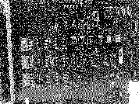

Much probing and staring at the board layout in sprint revealed loads of missing traces a number of which where in the startup circuit (there where also a couple around the RAM address mux's and a few elsewhere)
This got the board powering on but with no chime and no video, A little bit of probing later and it turns out the ASC wasn't connected to 5V, oops! One bodge wire later and the board was producing beautiful clear.... death chimes.
I spent hours trying to figure this out without being able to find any further issues with the board when I started thinking about my IIx, it's a pretty much identical machine hardware wise and I had a similar issue which after months of troubleshooting turned out to just have a bad ROM, maybe this was the same....
I stuck a ROM Simm socket on the board and chucked a SE/30 ROM in it and.....
More investigation revealed ROM MH at UA2 was bad, one 27C512 later and the board was booting with the onboard ROM :)

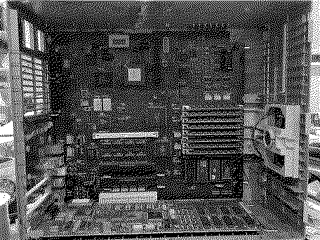

This was the point I did something I probably should have done earlier and test fitted the board in the case, whatever I did it just would not lay flat and I just couldn't figure out why......
Ahh yes, it helps if you remember to put all the locking slots in the board!
Never mind, I can vaguely hack a slot out the board
And it fits!

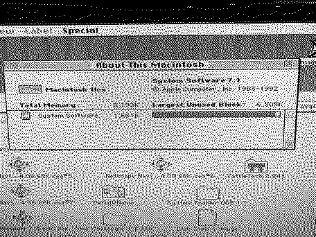

And even boots Mac OS
The board is bit of a tight fit in the case so needs to be slimmed down a tad and the latching slots are also a bit short making the speaker quite a tight fit so some adjustments are in order for the next revision
That should have been then end of it for now but just as I was about to go to bed last night I found two odd faults: first off only the left NuBus slot worked, installing the graphics card in either of the other slots gave a gray screen for a second then the computer would hang and installing two cards in any slots gave death chimes. Secondly I found setting the volume level lower than 2 made it lock up and then give death chimes on boot until the PRAM was reset which is a odd fault to say the lest!
The NuBus issue turned out to be that different arrangement's of ground pins are used on each slot to identify them and I had just copied the same arrangement for all 3 slots. a quick bodge wire got a second slot working (getting the third to work would require removing the connector form it which I'm not going to do)
The weird sound issue also had a simple fix: it turns our I had forgot to solder one side of the right sound chip, I'm guessing that when the volume was set to a low level the chip would glitch out and start yanking on the reset line (the machine was not resetting, but this is the only way I can really think of that one of the sound chips could crash the machine) Rectifying this allowed me to set the volume as low as I liked :)
