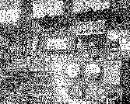

Pictured below, a very sad looking CUDA chip on my battery bombed Macintosh TV.
Screen Shot 2023-08-14 at 10.46.52 AM.png [View]
