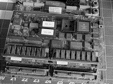

I've had this board for a while but haven't really looked at it much until recently. I have no idea what it's for, other than maybe driving an external monitor. I really can't find any information online about it either. My question is this - why would it need a 68000 processor and four RAM SIMMs if it's just a monitor card? I've seen plenty of Radius SE monitor cards that look like your typical video card (very different from what I have). Anyone have any input here? Curious what others think this is!

Jul 9, 2022 - #7
Wow - you've really outdone yourself! Clearly I'm no good at research... definitely didn't know where to look. That is so neat that this thing has a built-in accelerator.
That said, I don't think it's working how it's supposed to. I booted from Floppy EMU and was able to launch TattleTech. System is reported at 8MHz, which is strange. I was also unable to boot from my trusty BlueSCSI (hence the floppy).
The large resistor near the display port connector on the board I noticed was getting very warm and looks scortched. I am going to buy a replacement and see what happens when that's replaced, although I have no idea what it is for or if it affects functionality.

Jul 9, 2022 - #8
Happy to help, @Garrett! :) (y)
>> Garrett said:
That said, I don't think it's working how it's supposed to. I booted from Floppy EMU and was able to launch TattleTech. System is reported at 8MHz, which is strange. I was also unable to boot from my trusty BlueSCSI (hence the floppy). Click to expand...
There may be connection issues between the card and the PDS slot or towards the PDS connector on the card from the chipset along the circuitry. Also, software drivers may be required. I will try to find out. [face-with-monocle]
>> Garrett said:
The large resistor near the display port connector on the board I noticed was getting very warm and looks scortched. I am going to buy a replacement and see what happens when that's replaced, although I have no idea what it is for or if it affects functionality. Click to expand...
Definitely! I suspect recapping and trace checking are needed, too. Welcome to the uncharted region! [nerd-face]

Oct 5, 2024 - #9
Do we have any ROM dumps of this thing around? Mine doesn't have the ROM HI or ROM LO chips installed. Didn't come with it: perhaps they're AWOL? Not needed?
Worse, I don't have an SE to see if it works...or a 68881 FPU...
EDIT: Looking closely at the images on first post, your resistor? I measure 5.6 ohms? has been a little toasty before...
The oscilliator Y1 is 57.2832MHz on mine, i have two jumpers on RS2 and RS1 (just between the CPU and FPU. Noted two electrolytics underneath the board, C37 and C38. Both are 25v 33uF.
