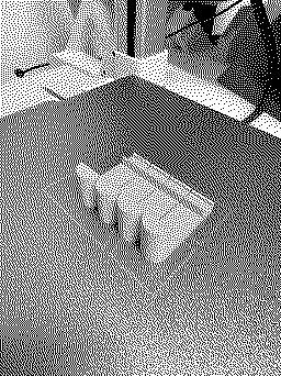

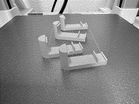

We are working on a Quadra 700 Feet project. The points we are aiming for are as follows.
1, Toning close to the original
2. Use a material that is not too soft
3, Design faithful to the original
This will be available for purchase at our Kero 's Mac Mods Shop. Since 1 is due to the original material, it is impossible to have the exact same color, but we aim for something that does not feel strange when attached to the Quadra 700. In the video, the black dye is extruded, which is a prototype, but the black dots are scattered.
2 uses soft plastic. The same rubber material is too soft and difficult to produce.
3 has been redesigned to reproduce the press line when it was molded. The semi-circular hole on the back has the same shape.
IMG_7456.jpeg [View]
IMG_7457.jpeg [View]

We didn't make this product because the cost was not worth it! Thx for interested with this:)
@Paolo B
@pfuentes69
Of course, it fits because there is a commonality of shell cases, but unfortunately it ended with a prototype for the above reason.

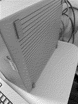

Just printed those:
They look good (I know, I know, wrong color) and fit snug

Printed them again in Bambu Lab Bone White Matte PLA
1763397867558.jpeg [View]
