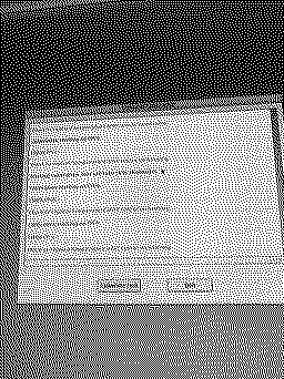

Hi, I recently resur my G5 by reflowing the U3 memory controller on the logic board and it's working again. I tried calibrating the fans using ASD 2.5.7 on my June 2004 G5. But I get errors for both cpus about this inlet temperature sensor which I'm not sure what that is. I had the plastic door on and the metal side pane. Any ideas?

I left a sensor unplugged so now it calibrates fine
