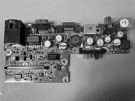

The PowerBook 2400 uses tantalum caps on it's motherboard but has some atypical (for Apple) through-hole electrolytic caps on its power/IO board.
LocationCapacitanceVoltage RatingDiameterHeightTemp Rating
C39100uF10V10mm6mm105º
C48100uF10V10mm6mm105º
C47150uF6.3V10mm6mm105º
C38220uF10V10mm10.5mm105º
C46330uF6.3V10mm10.5mm105º
C2610uF30V8mm10.5mm105º
C1533uF25V10mm10.5mm105º
C2510uF30V8mm10.5mm105º
IMG_6679.jpeg [View]

Curious, has anyone brought a "dead" 2400c back to life by recapping its power/IO board?

Ah, those aren't electrolytic caps. They're Sanyo OS-CON caps which are solid polymer and won't leak/are very unlikely to fail. Still good to have the values just in case but the chance of one of those failing is next to none.
May 4, 2023 - #5
Oh interesting. Saw cans and assumed electrolytic. Thanks for the correction.

If you see that purple, you're usually safe :)
